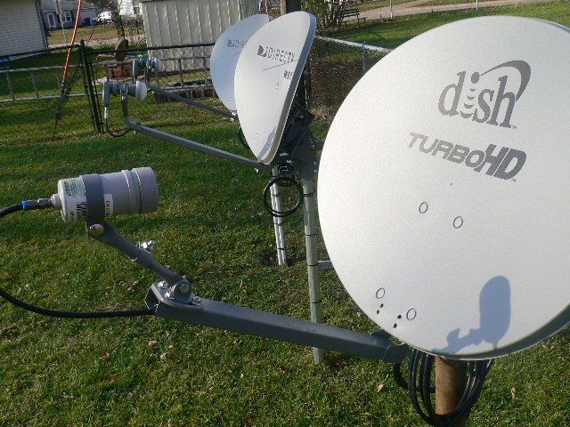

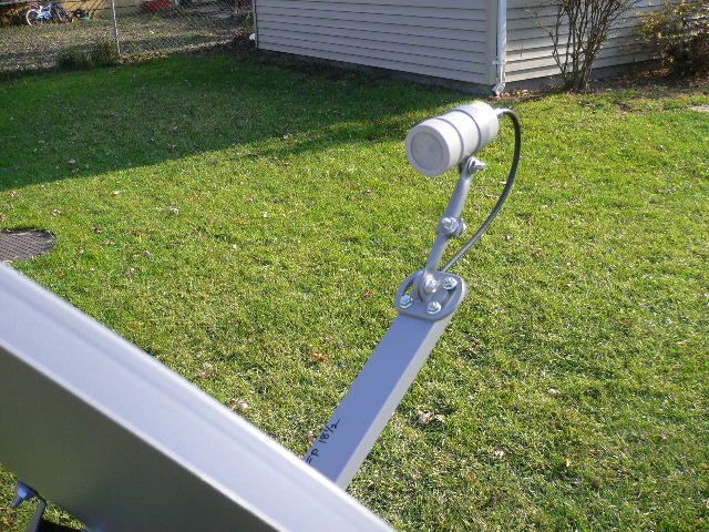

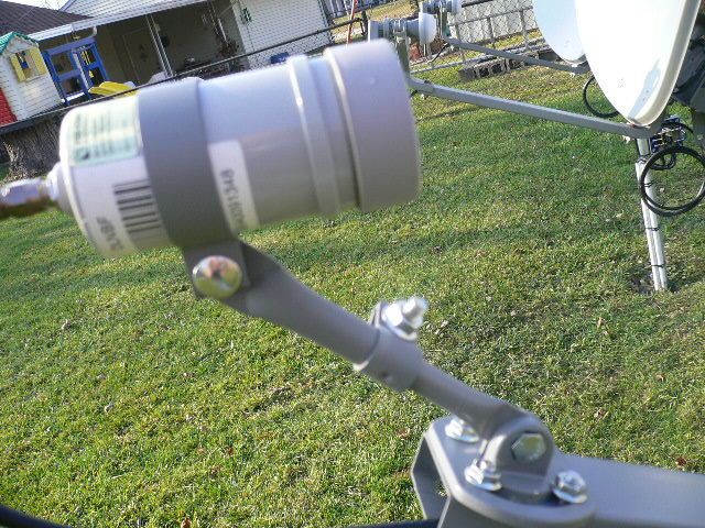

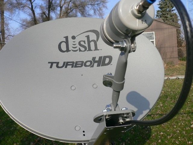

After noticing the "wobble" the monopole has since it is kinda long, I though that I should take the length out. So after a few cuts I think I have solved the problem. Cut the monopole into 2" sections, there is no wobble what so ever and it looks and feels much more solid, More permanent and professional so to speak.
Here is the final result after cutting the monopoles.
On the original method, I was going to offer that fixing the monopole to the LNB arm would be an improvement.
But you made a much better change. The moment arm is shorter...
Good job...

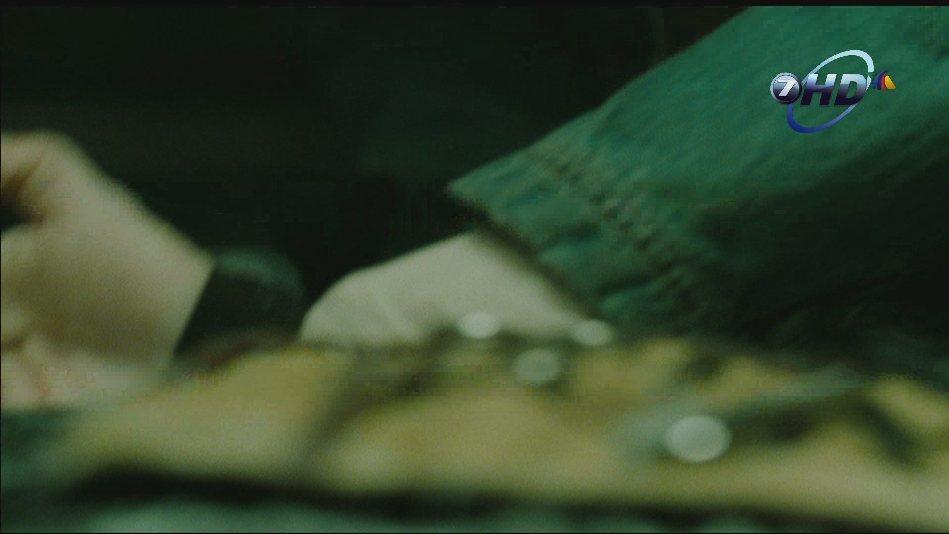

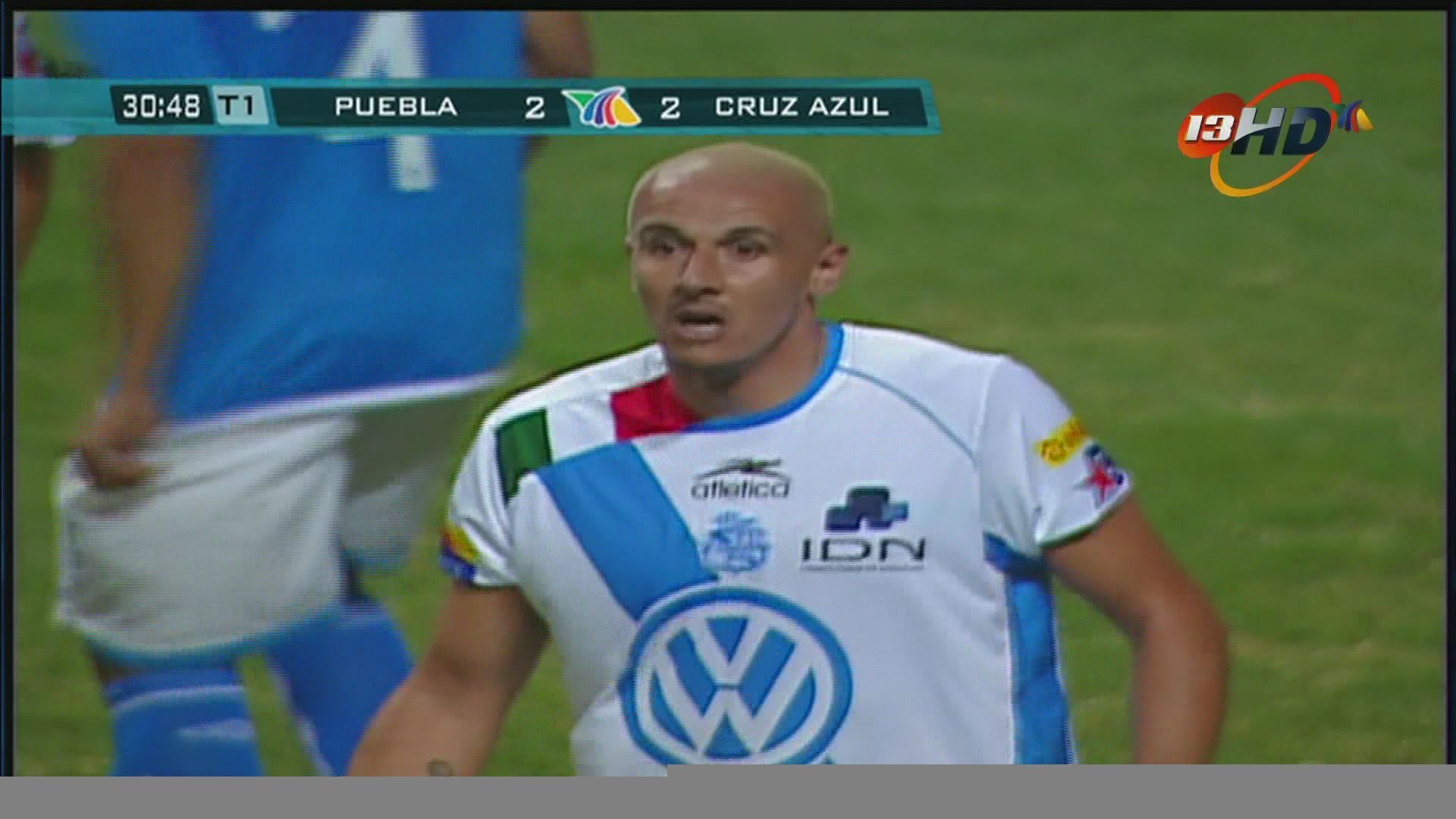

Well today is peeked it at 121w and I was able to get the Azteca HD's on TP 3851 DVB-S2 and got 66% signal.. how about that on a 6ft getting 66% on C-BAND DVB-S2 8PSK :)
here some caps on Azteca 7 HD and Azteca 13 HD
