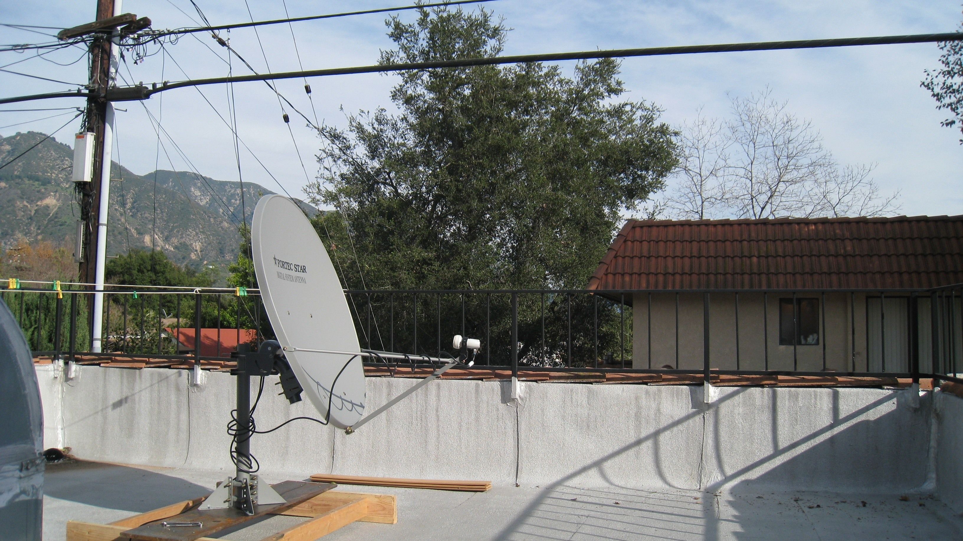

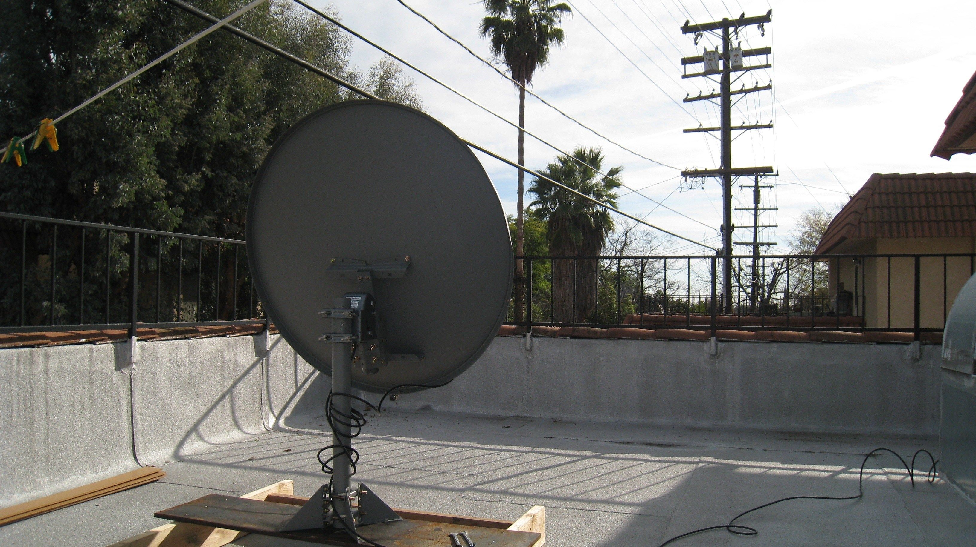

Radar,
Please see two pictures of my dish on the top of the garage and let me know if the wires in the front of the dish can make signal quality = 0
The current position is a temporary one.
After I learn to use the equipment, I,ll move it to the house roof.
View attachment 60165View attachment 60166a temporary location until I learn to use the equipment then I'll move it from the top of the garage to the house roof.
Vpaniyan,
Well, your satellite signal is quite a ways over the top of that nearby power pole with the two transformers on it. The satellite in orbit is much higher in the sky than you realize. If you could see it in your picture that you posted, it would appear maybe about fifteen feet above the top of the electrical pole. Maybe more. There is a lot of junk in front of you, but the physical junk isn't blocking your LOS (line of sight). I don't like it much, but I don't think that is your problem, not the physical items (the poles, wires and the transformers that we can see). But, there is going to be a LOT of interference from the electromagnetic field surrounding the wires and especially the transformers. That is the other part of the "background radiation" that your LNBF is going to pick up on.
Those power cables are probably carrying 8000 to 13000 volts up to the transformers and then are downconverted to 220/120 volts for your home and for your neighboors. There is a lot of energy there and that energy in those wires and transformers create a "bulge" of electromagnetic radiation in that area. You are aiming your dish right through it.
If you were aiming through just a couple of low voltage lines, I wouldn't say boo. But, you have a LOT of power cables directly overhead and really close and right in your LOS. That can obscure your signal from the satellite.
I don't know how strong the signal from SatMex 5 should be for you, but you have a LOT of background radiation and electrical noise that might just overpower the signal from the satellite. It may bleed into your LNBF simply due to the proximity of the LNBF to this unwanted noise source.
In other words, I don't think that it is blocking your satellite signal, I think it is overpowering it. Your receiver's tuner cannot differentiate the satellite signal because the background "NOISE" or interference is too strong.
I may be wrong, but that is my assessment of your situation here. If any one has better information, please jump in and assist.
