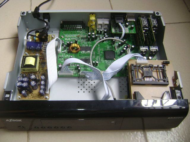

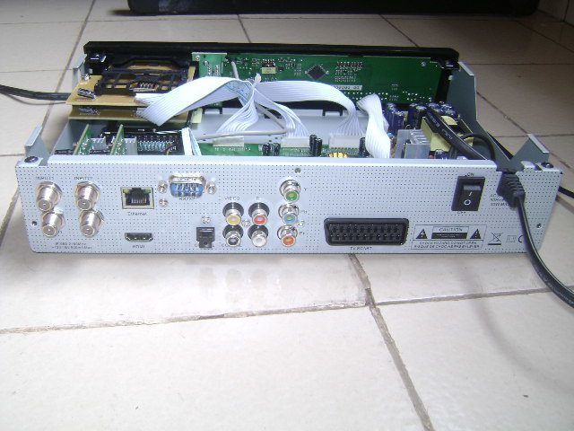

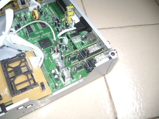

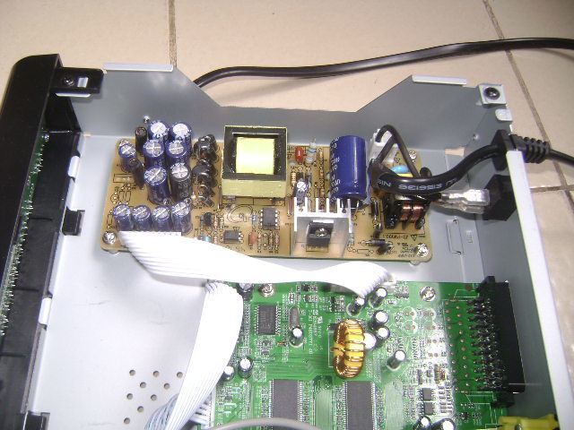

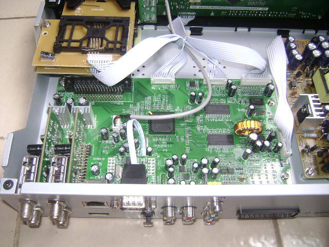

Hi, I bougth one here i Brazil, so here some information:
- Ali M3602 Hd decoder, 2 x M3501 S2 demodulator, 2 smartcard reader, 1 common interface slot, 8 character display, 1 serial, 1 hdmi, 1 ethernet, 1 usb external, 1 usb conector intern for usb pen drive, universal power suply, no heating at all.
- No sign of origins, only the Azbox logo on front;
- Simple (or poor) software, but has all basic receiver needed.
-diseqc 1.2 buged, not ok.
- no 4:2:2;
- good sensitivity, locks 1400MS to 45500MS qpsk or 8psk;
- blind search with only h/v control: from 2000 to 42000MS easily, up to 45500MS not always;
-has two tuners, but no pip, only one tuner at a time can be used for video;
- some small bugs, sometimes halts and resets alone.
Some pictures:
