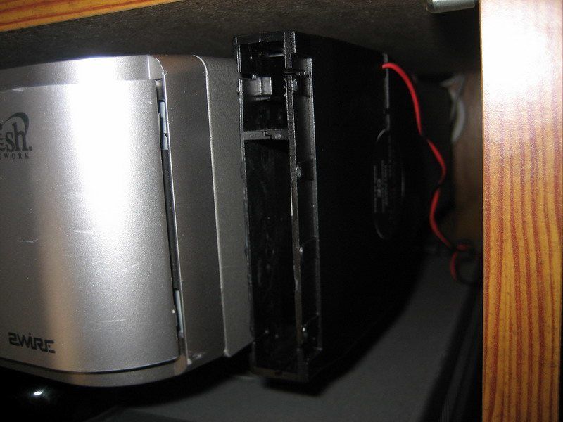

I have a 622HZ that really struggles here in NV. I am using a laptop cooler which makes a big difference. I also have a PC Pancake fan pushing air into the back of cabinet that helps getting fresh air to the cooler pad.
The other day I found a PC fan that goes into a PCI Card Slot and directs air out of the back of a PC. It is only 1/2 thick. I pulled off the bracket, and double-sided taped the intake side of the fan over the right side ( as you look at the box) vents on the 622HZ. It pulls air left to right through the box and jets it out the right front side of the cabinet. I have cut the volts on both 12V PC fans to 9Vs which really quiets them down. I used wall bricks with variable outputs to do this.
My average temp has stayed at 40C since adding all three. I think the slot fan is actually the most effective. I am going to cut the other two loose, one at a time, to see what happens.

Attached is a picture of my PCI Card Slot Fan Mount. The round opening intake side of the fan is double-sided taped over the right side air vents on my 622HZ. The hot air is blown out into the room. Temps are now 39c low, 43c high, and 41c avg. As you can see I have the box in pretty tight quarters.
I also have the box sitting on a laptop cooler and another pancake fan blowing into the back of the cabinet. Temps were high 40's until I added the Card Slot fan. I dropped the volts to 7.5 with an adjustable Radio Shack wall brick to lower the noise.
If you read this thread, you'll find that the 622 is designed to pull air IN from the right side and send it right to left through the box, which is why we are all putting our exhaust fans on the left vents.
This is left and right as viewed from in front of the front panel.
SO, your fan is actually competing with the internal fans...
I thought the fan pulled down
I thought the fan was under the hard drive in the middle of the box and exhausted air downward. I also read the fan seldom runs anyway. I used the right side vents on the 622HZ as they are just the size of a pancake fan and airflow can be forced through this path. The vents on the left run the entire depth of the box and placing the fan there allows air to seep in at the edges of the fan.
My temps are in the low forties, warm air is coming out of the fans, and the box is cool to the touch. I must be doing something right.
