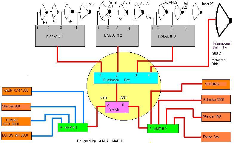

Hi guys please look at the attached file which contains my 11 dishes farm connections , I designed this system so that all the 8 receivers can receive all the 11 satellites simultaneously by using 2 AMPs and 2 Distribution switches,
( A+B+C+D) switch and ( A+B ) switch both works by remote control , located in the yellow circle in the diagram . This system works perfectly with me no problem with it . But my question to you , I need to substitute the switches in the yellow circle in the diagram By Only one Automatic switch without remote control and does the function of these two switches .
Any thought you would have br greatly appreciated .
