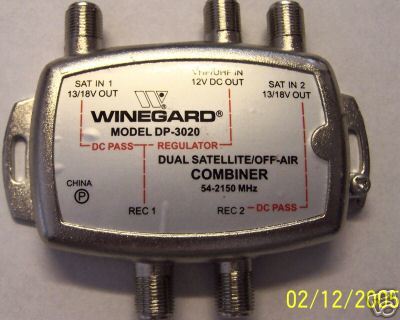

by using a WINEGARD MODEL DP 3020 dual satellite /OFF - AIR COMBINER , you can power your voom winegard sensar II or winegard ap series antenna preamplifier you can power your ota antenna with this combiner and 1 standard diplexor no power supply or extra cabling needed, see picture below

Tap it into the nearest convienent receiver feed cable - that does NOT already have a E* power inserter on it! If you need two feeds, use the REC 2 side, too.
Put a standard diplexer near the receiver to feed it's OTA input.

Wow, this is so confusing for a newbie. I just switched from Voom. I have what I believe is a Dish500, an 811 reciever on my HDTV and some type of dual tuner on 2 standards. So if i get this DP 3020, I need to hook up the two cables coming from the dish into the "Sat In 1" and "Sat In 2" spaces, then hook the cable from the antenna into the "VHF/UHF In" space, then get a simple diplexor to combine the "Rec1" and "Rec 2" spaces? Is that right? And if that's the case, what do I do next? just go into the installation menu and scan for digital locals?

yes it will work for a all dish receivers, install the unit between the dish and receiver before it hits any multiswitches at the dish end and at the receiver end using a standard diplexor at the receiver end you will have 2 outputs, one for ota and the other for satellite

Scenario: I live in Peoria, AZ. My house faces due east. In order to get the VOOM bird, they had to mount the dish on my block wall fence. As a result, the winegard combiner was mounted there too. When E* was installed, they mounted in on the house for better reception. However, the winegard was still on the wall and then he used another combiner at the house.
Here was the problem: Instead of using the Sat input for the dish and the in/out for the receiver, he used the Sat input for the receiver and the in/out for the dish. Hence, no OTA signal was being routed to the receiver end.
My solution: Removed the E* provided combiner outside and re-routed the cable from the OTA antenna (just buried under the 1/2" rock that blankets our yards out here) to where the E* dish is and also moved the winegard combiner.
