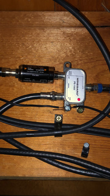

Channel 61 is spotty at my house and I'm thinking it may be due to LTE interference.
I just ordered a CM LTE/5G filter to see if that will resolve the RF36 (WFSB) issue. No antenna issues. I was told back in 2019 that I may need a filter for my location.

I installed the LTE/5G filter tonight. I have noticed 32 (WRNT-LP RF32) and 3 (WFSB RF36) seem to be stable and no pixelation, which is a first.
I also realize I need the amplifier on as those two channels don't come in without it on.
