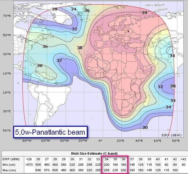

4w-5w-11w

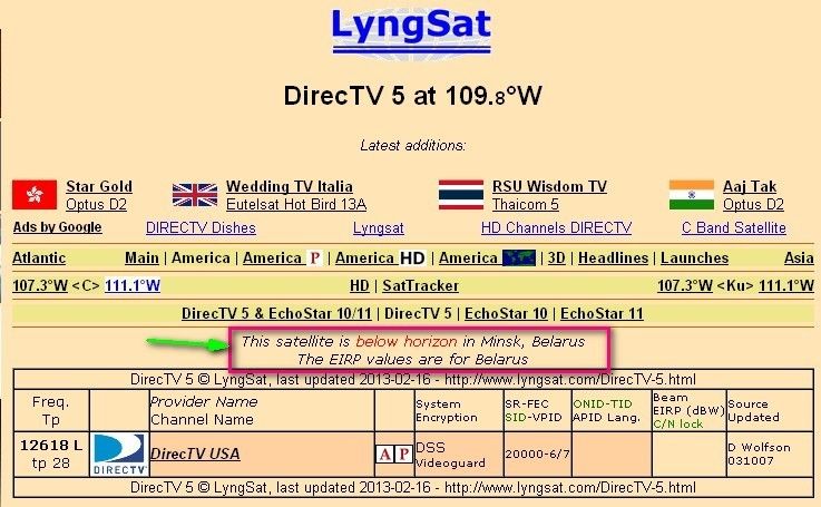

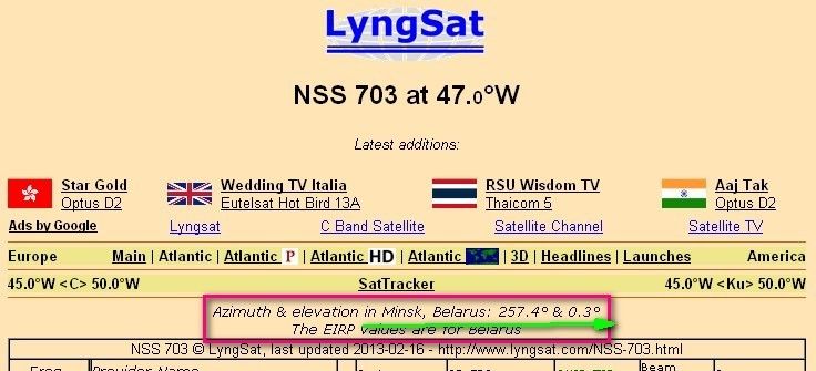

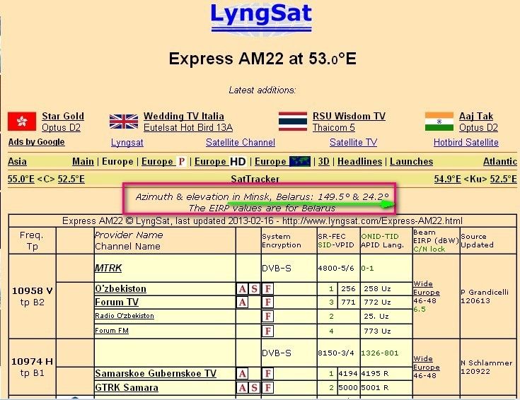

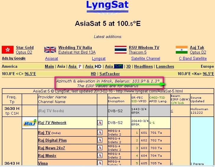

All good evening. I will tell as I at home searched itself for distant companions the East-West. =????? = to establish the on the Southern companion the position 28,2e, on the West the motor has moved to 37,5w - on the East to 95,0?.
And if the fixed aerial to me to adjust, the Western companion the worker for my district-47w. th Vostok-100,5e.
On a site =LyngSat=???? the good help. We come on a site, we open any companion which shines on you in your district and there it is specified Azimuth and Elevation where it is necessary to adjust Dish.???? you adjust fixed Dish.
So you in the USA can calculate itself extreme companions that shine on you in your district.
Has looked on card thy C?? there is a companion 4w and the beam =USA Beam=?? on it is not present channels for you. The extreme companion it 4w for you Means itself.

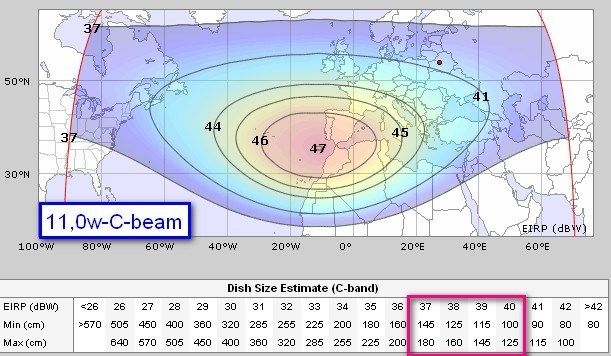

On the companion to 11,0w th frequency 3662 R-10808 1/2 there are 2 Russian channels th Dish it is necessary 1-1,8m and it is better fixed Dish to put.
3 photos are my image. The Photo-.N-4-companion 100,9w-is visible that the program of site LygSat answers that 100,9w to Belarus does not shine. It is an example was
