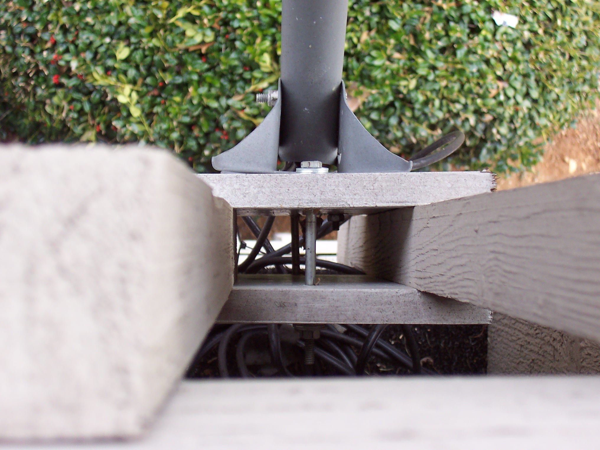

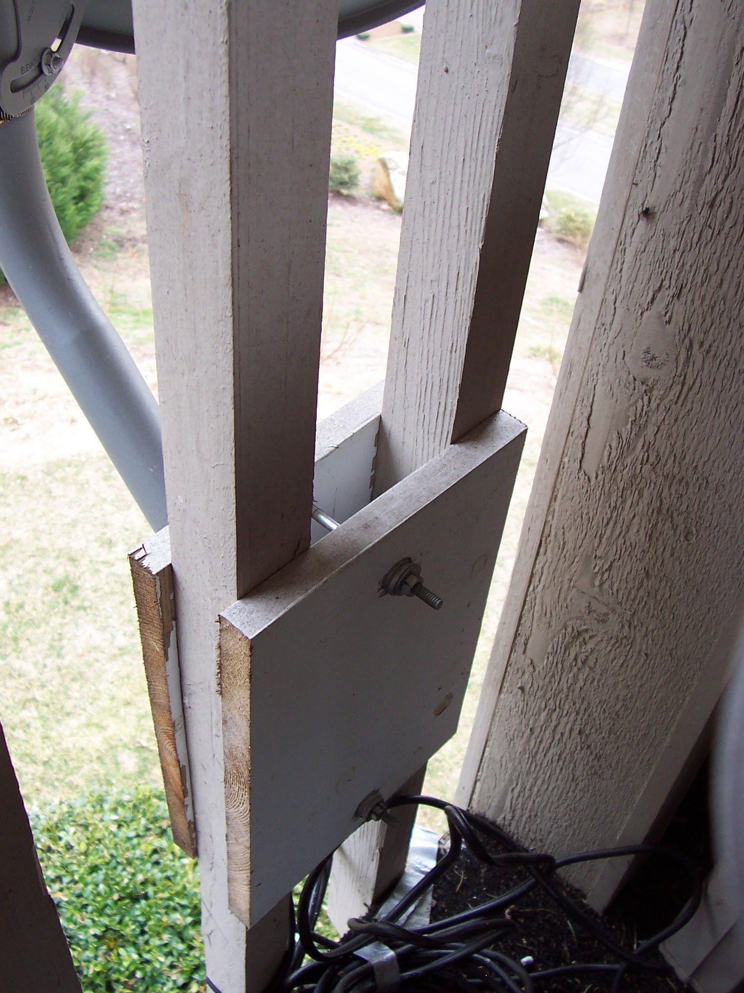

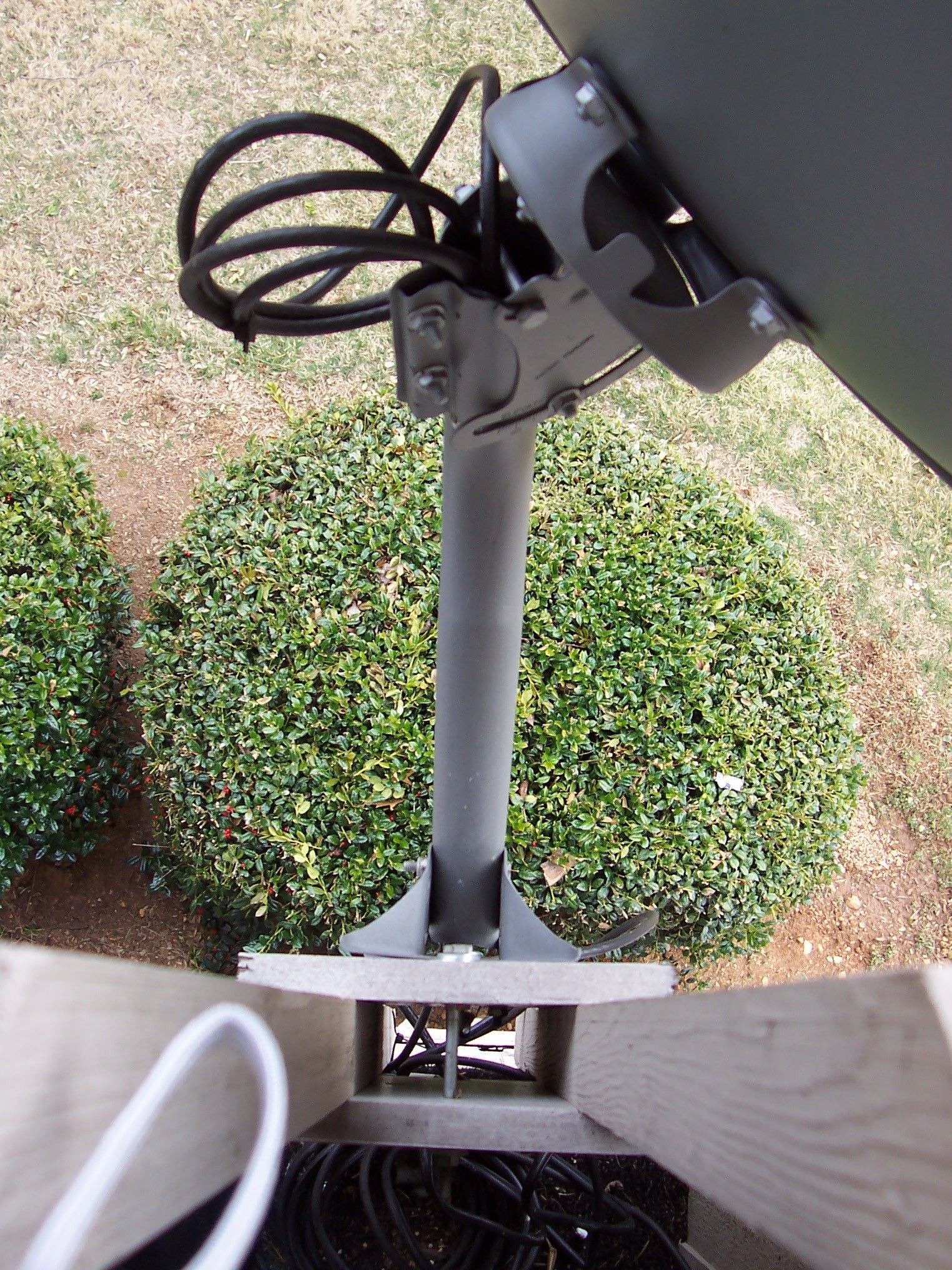

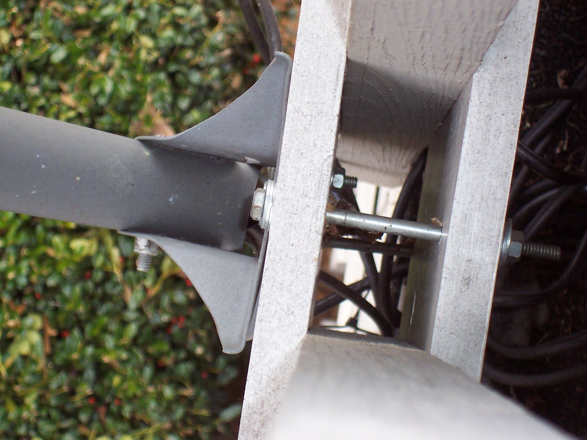

Depends on how you have the 3 LNB mounted. I have the my 3LNB mounted on a piece of 1*8. I have another 1*8 bolted on the other side of the uprights. Kind of a 1*8 sandwich with the uprights for the deck railing in between. The span across this part on the railing is about 5 ft so this has the stability IMO to hold the 5LNB dish. If I can figure out how to post a picture, I will show you. I also have D* coming out on 25Feb06 to install. I realize that the new dish is heavier, but I think if I can stabilize with one mono-pole, I should be ok. This is mounted on the south side of the condo in a protected area from the wind. If anyone has additions or ideas please let me know.

Sure, the easiest way is to follow the directions in my sig to my site and open the page with the pictures of my dish, showing the extra arms. As for the base of the AT9 arm, I still believe it is the same size as the 3LNB unit was (not 100% sure), but the arm is bigger around. If the base gives you problems fitting your 4X4 then simply drill new mounting holes in the base, that is what I did. Mine was not a self install but I did help the guy install it, On the 2nd night it was out there we were hit with 50+ MPH winds and I watched HD channels off the dish with zero issues!!!!
Have the installer put 2 support arms on if possible. I believe the more support from different directions is always a good thing!!!
