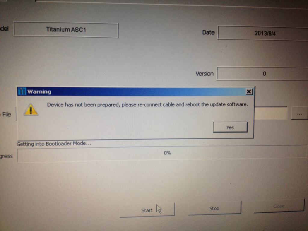

So far the null modem cable is not communicating. I tried powering the asc1 down several times with the switch on the back and rebooting my PC several times. Serial port is set as com 1 , 9600 bps.
I'm still trying...
ImageUploadedBySatelliteGuys1388385121.284731.jpgstill getting the error message.
What loader and what firmware are you working with? Are you using Friday's beta loader and beta firmware?
Serial com port should auto configure to 56000 bps by the loader config. USB/Serial adapters are notoriously flaky. I gave up on using them long ago and spent $8 on a PCI SIIG Serial DB9 RS232 card.
I have attached RS232 test software. Set up as shown with the attached JPEG. Enter 45 in the text window near the bottom left of the screen, then press Open.
Sending HEX text 45 to the ASC1 should receive back 30303030303030.... repeating. If 30303030..... is not received back, there is a com issue with the USB/Serial adapter.
I keep an old IBM Thinkpad Pentium 3 laptop with 9 pin serial port and running Windows XP for use such as this. Works perfectly every time. I never was able to get those USB to serial adapters working to the point I trusted them. The old Thinkpads had both USB and 9 pin serial ports.
If you can find one, they are good to keep around for purposes such as this.
After countless hours of trying. I cannot get any of my pc's to communicate with the asc-1. I am going to smash it with a hammer lol. I hooked my analog receiver back up.

So what was the result of the RS232 test program? Did it return 3030303....?

Brian, it just keeps returning communication errors. It says to reboot
And reset
