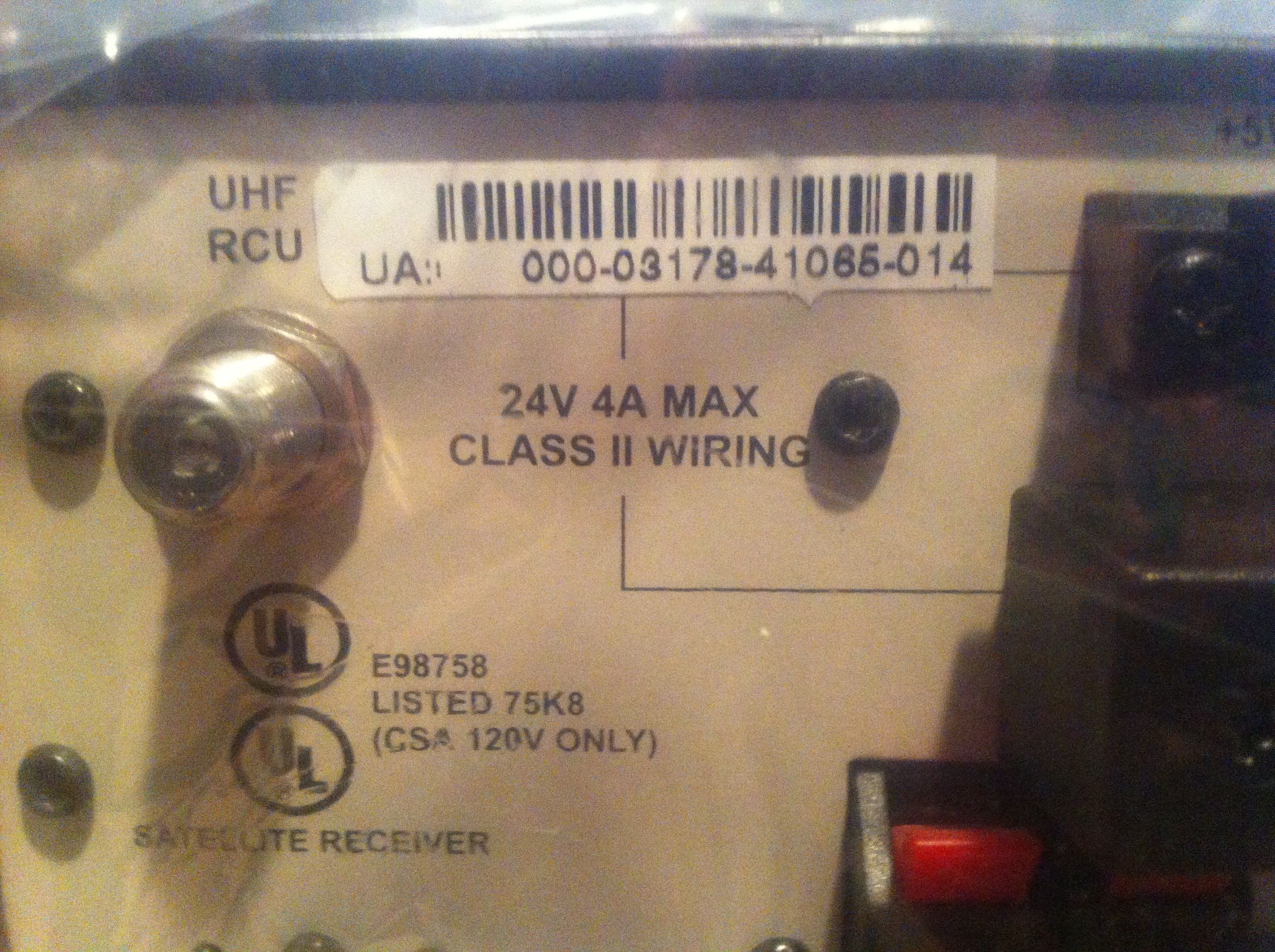

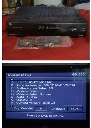

It seems that everyone says the Unit ID on screen should match what is on the back of the receiver to verify the battery is still good. However, the number on the back of my receiver matches Item B: Receiver Number on my status menu, not the Unit ID number. Does this mean my receiver is still good, or bad? Thanks.

Yup, it's still good, however you really need to verify the battery voltage & year of installation by opening up the top. Check the battery carefully so as not to short it. If below 3.2v consider a new lithium battery mandatory. Me, I'd replace the battery just for general principle for insurance & peace of mind.
