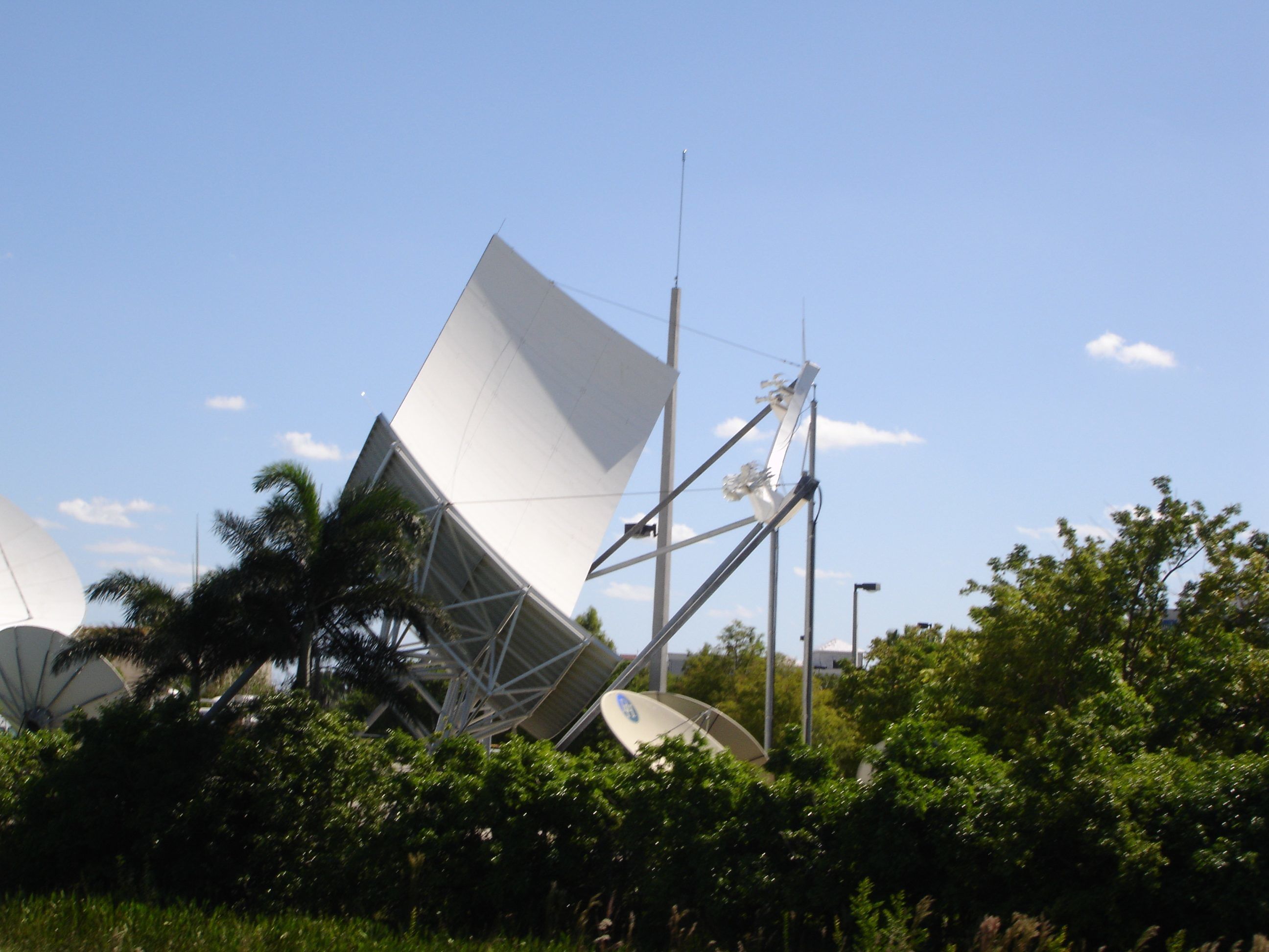

Hey Guys,
Here in south florida the local NBC station (WTVJ) has on of these big antenna. My friend who work at the station told me that there is only 3 of these antenna being use in the country. I can tell you this antenna is BIG!!!!!!. I took this picture after reading this post. I am not to far from the station (10 minute drive). When they retire the antenna they should give it to some skate board nut. It has a great slope just for that.

There are many more than just 3...
http://www.atci.net/C_P_SimulsatProjects.htm
Two of my customers still have Simulsat3s on their property. One is still using theirs but the other has dropped their private satellite service for cable.
The Simulsat3 is much smaller than the present Simulsats, with it surface measuring about 12' by 22'. It has the gain of about an 8' prime focus, but its adjacent slot rejection is more like that of a shallow, six or seven footer. As a result, when a satellite in an adjacent slot turns on a digital transponder of the same polarity, but one channel number higher or lower, the analog feedhorn's signal gets degraded and we have to then switch that analog channel to DBS transport, which costs a little more.
The other pain-in-the-butt aspect of these old Simulsat3s is that they were designed back when satellites were 3 degrees apart, and it is not even physically possible to place feedhorns for adjacent satellite reception, which means they can be set up to receive F3 and F4, but I can't fit a G1 feedhorn between them. Nevertheless, they are nice for permitting a C-band system to pick up a signal from an odd satellite at a reasonable marginal cost. We are using one to get Comcast Sports from the 81 degree slot, whereas if I had to install a separate dish for that one program, the cost would have been prohibitive.
