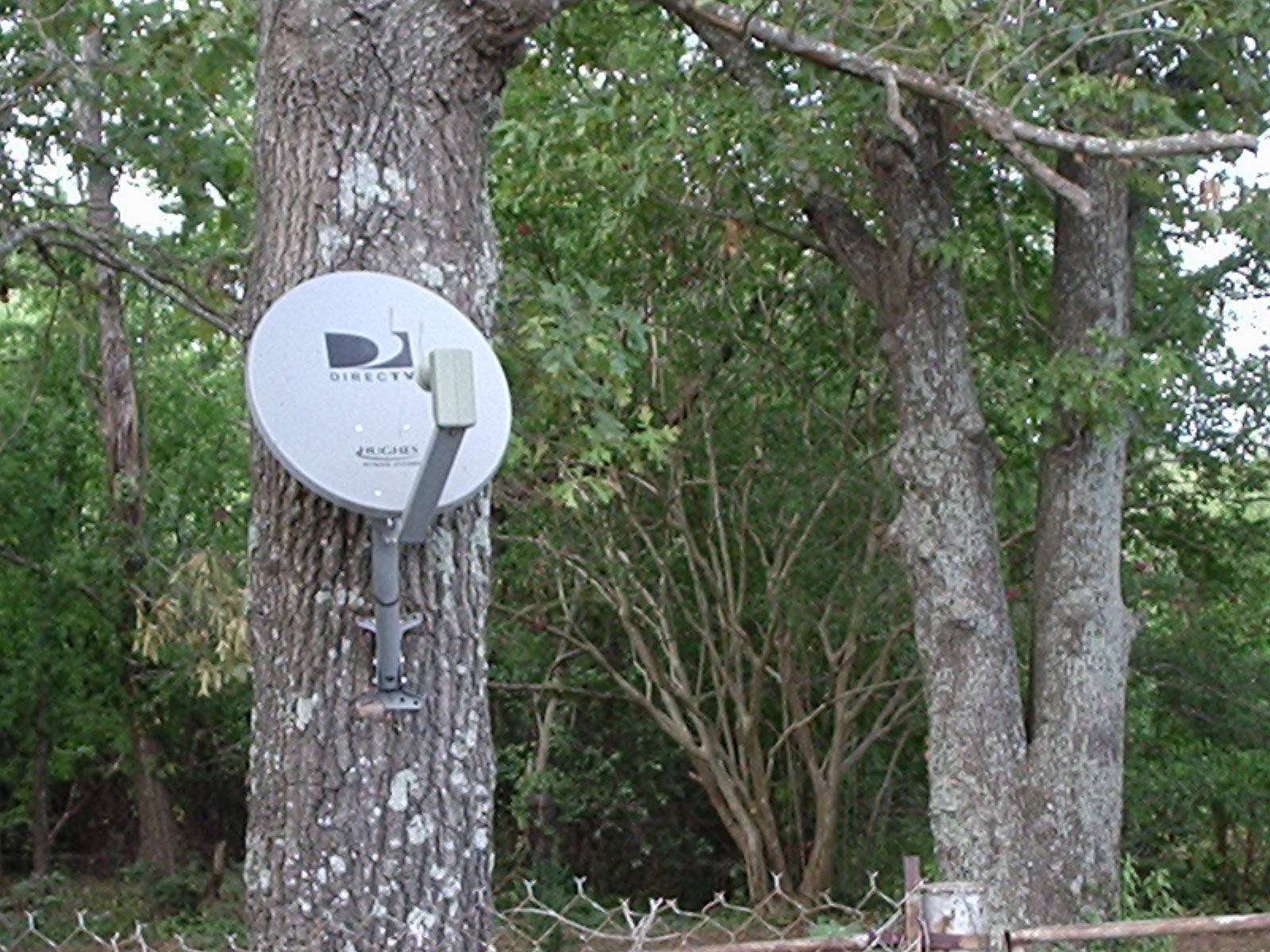

Here is one I saw while I went to do an installation last month.
views on the install itsself and an installer will differ here, you have to decide how much you want the tv and the installer has to decide how much he wants the completion. Frankly I will never install a dish on a tree thats young because it will still grow wich will turn some and will pop the heads of the bolts. I have installed 2 dish's on tree's before that were alive, I had to seperate a 500 into 2 300's to get 119 and 110 through a stand of tree's, the customer was adamint and my boss likewise. Signal was 123% on the 119 and 105% on the 110 with a strong breeze. Ive also put one on a dead tree, likewise Ive had to remove one from a tree that was young and had grown rather fast after 6 months and popped 2 of the bolt heads off. Its a gamble to do it and not very professional but if you really really have to have it mounted to a tree and the tech can get cleared for it by his supervisor and your willing to sign off on his paper work taking complete responsibility for the job then go for it.
