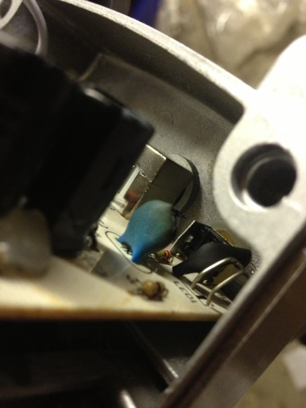

So I hooked up a sg2100 and a 24volt power supply just to see. And well the motor was rolling super fast until a cap popped.

Brian, the limit we run into here, is not exceeding the current available from a receiver.
It's time to get serious and move on to 1/2 or 3/4 amp, 24 volt motors! ;)

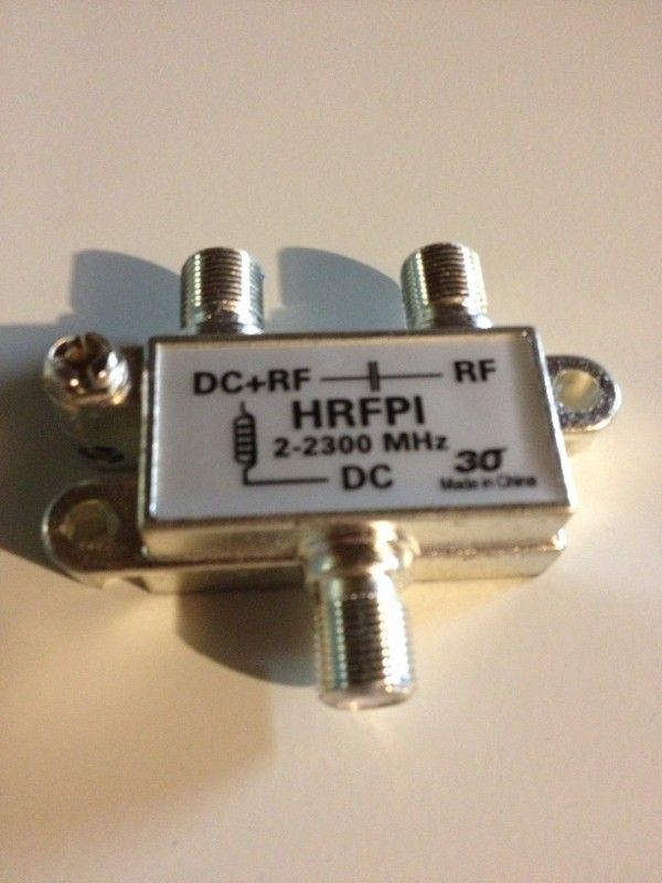

Those could be powered either through a third connector, or...
Pendragon described a motor mod where one coax connector was used exclusively for power.
The other existing coax received USALS commands and didn't provide a pass-through.
That function was handled externally, through a power-passing diplexer, if I recall.
:) I like it..
Something like this may do the job.

I agree that independent power supply and beefy motor would be a much better solution.
I played around with a modded motor as was described. The 24VDC power supply was in the office and ran lamp cord to power a standard HH motor. Retained USALS and DiSEqC 1.2 control. A bit Frankenstein, but worked much better than 13/18vdc on lifts off of the horizon.
