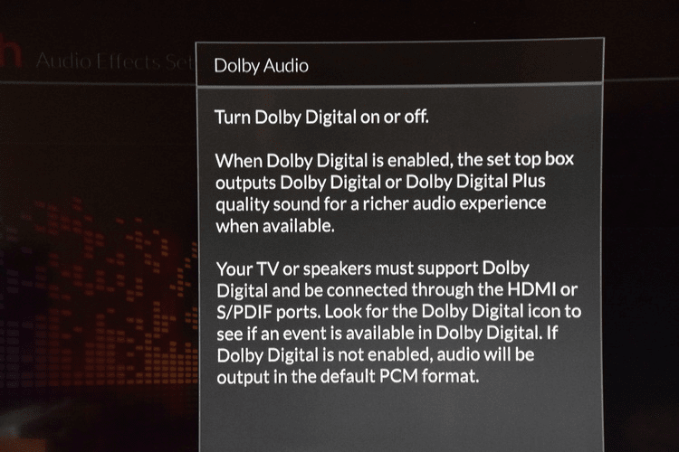

Actually, I have to apologize, I made a mistake about the Prime app on Joeys. Amazon required that the Audio Output of the devices that host the app have Dlby Digital + and only the Hopper 3 has that.
Interesting, thanks.
When I go into the audio settings of my 4K Joey, this specifically says Dolby Digital Plus may be output. Is it wrong?
I think the statement is generic to the CUI that the 4K Joey uses. Note that it says Dolby Digital or Dolby Digital Plus. It's just a generic CUI slate that is used for the entire Hopper, Joey, Wally series.
