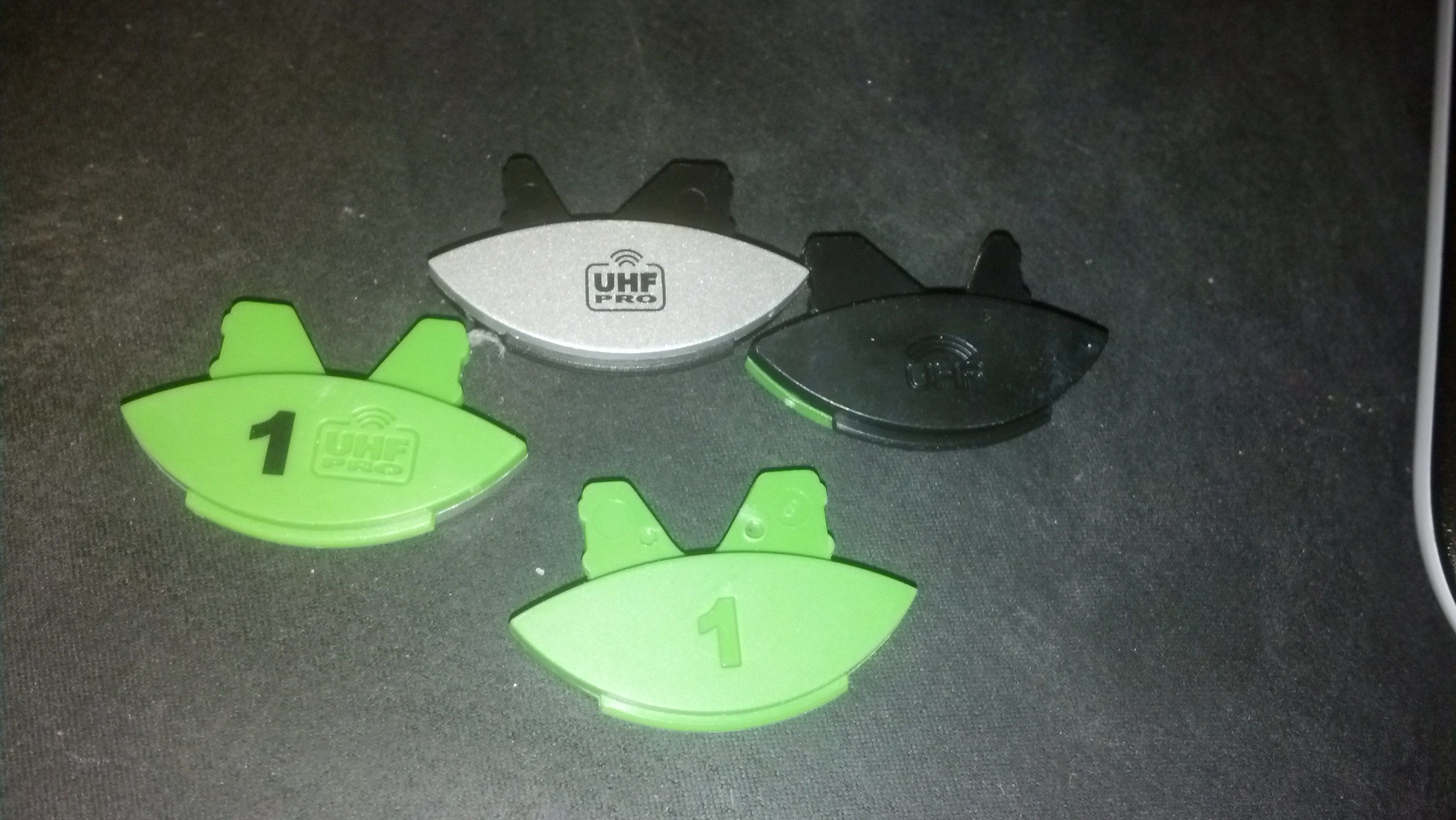

If you open the battery case the 6.4 blue tv2 tab should be green on the reverse side. Flip it over to the green tv1 side press system info on the rcvr and press record. It should change the remote address.
when I pull out that tab (just figured out how to do that) ;) the other side is black
will have to try that when I get to my dads
also I noticed on the 6.4 remote there is a A/B switch on the side of the batteries. What does that do?
I was going to suggest that, or I'm thinking Remote Channel 1 on the receiver will work with any of the remotes?
take note of the groove positions.
Reactions: Mr Tony
Put it on the black side and program address. Should deactivate UHF and be able to control as TV1. That's what I did here.
Reactions: Mr Tony
After switching around the keys, don't forget to push menu twice in the front receiver buttons and then push record on the remote to pair the remote with the receiver.
