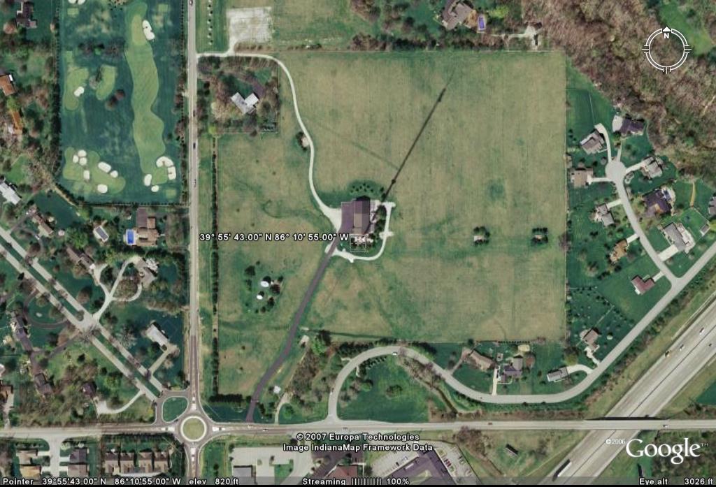

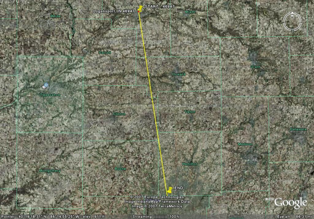

You seem to be about 60m away from that tower (39° 55' 43.00" N 86° 10' 55.00" W); so you will need to get a quality antenna up high, at or above your roof line; maybe some ideas if you can tell what other channels you might be interested in, in your area. This one in particular is UHF and if its the only interest maybe look at something like the Radio Shack Model: VU-190 XR | Catalog #: 15-2156 simply to buy it local and try out the results and have easy returnability.

And add a Channnel Master 7777 pre-amp, no guarantees, you are down in the river valley but good signal is 300 ft above you.
VHF analog stations should be attainable, play around with the options at the bottom of the antennaweb input page, at around 250 ft elevation you even start to get digitals out of Indianapolis.
Moving north to about CR300 also gives you better Indianapolis reception, So much depends on elevation and location.
