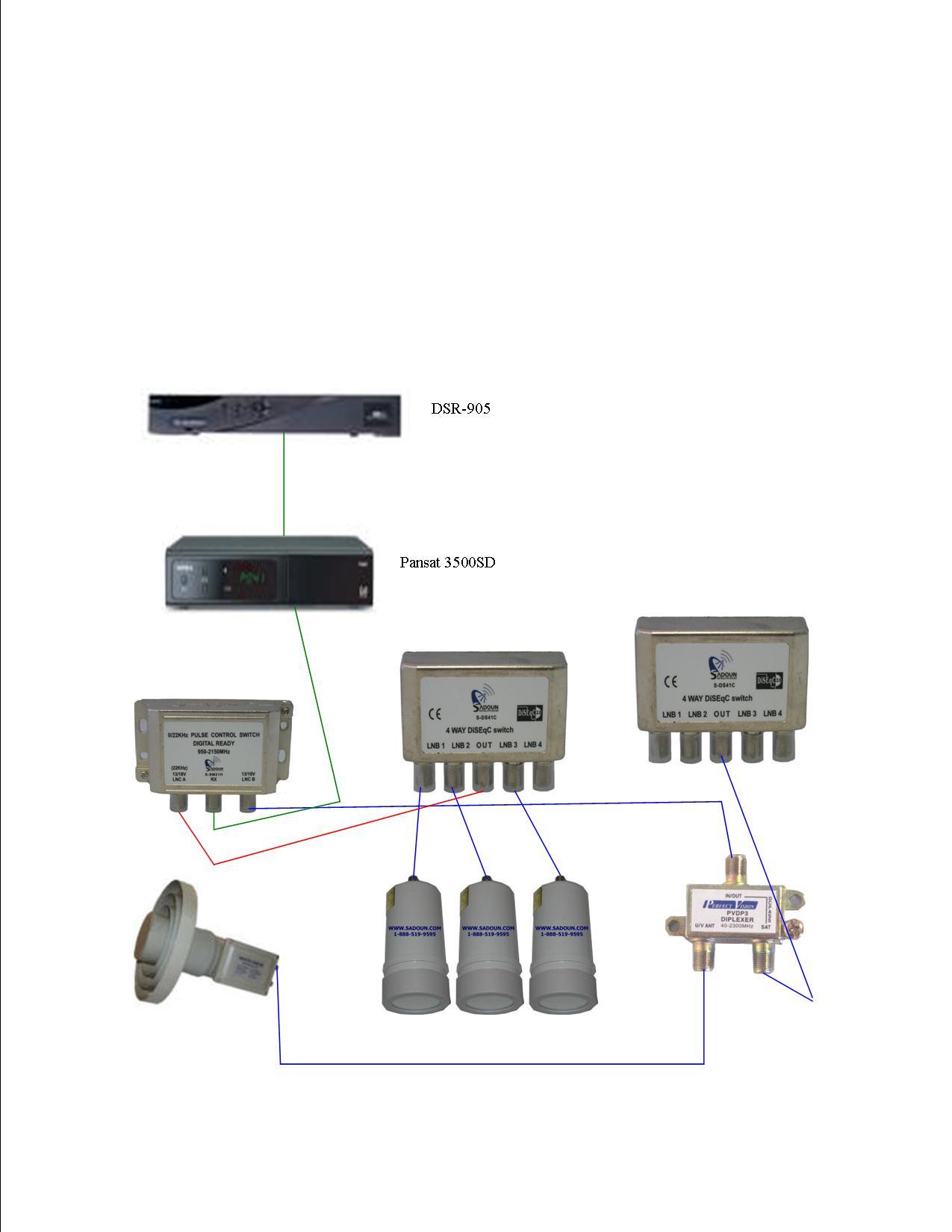

Any reason why this would not work?

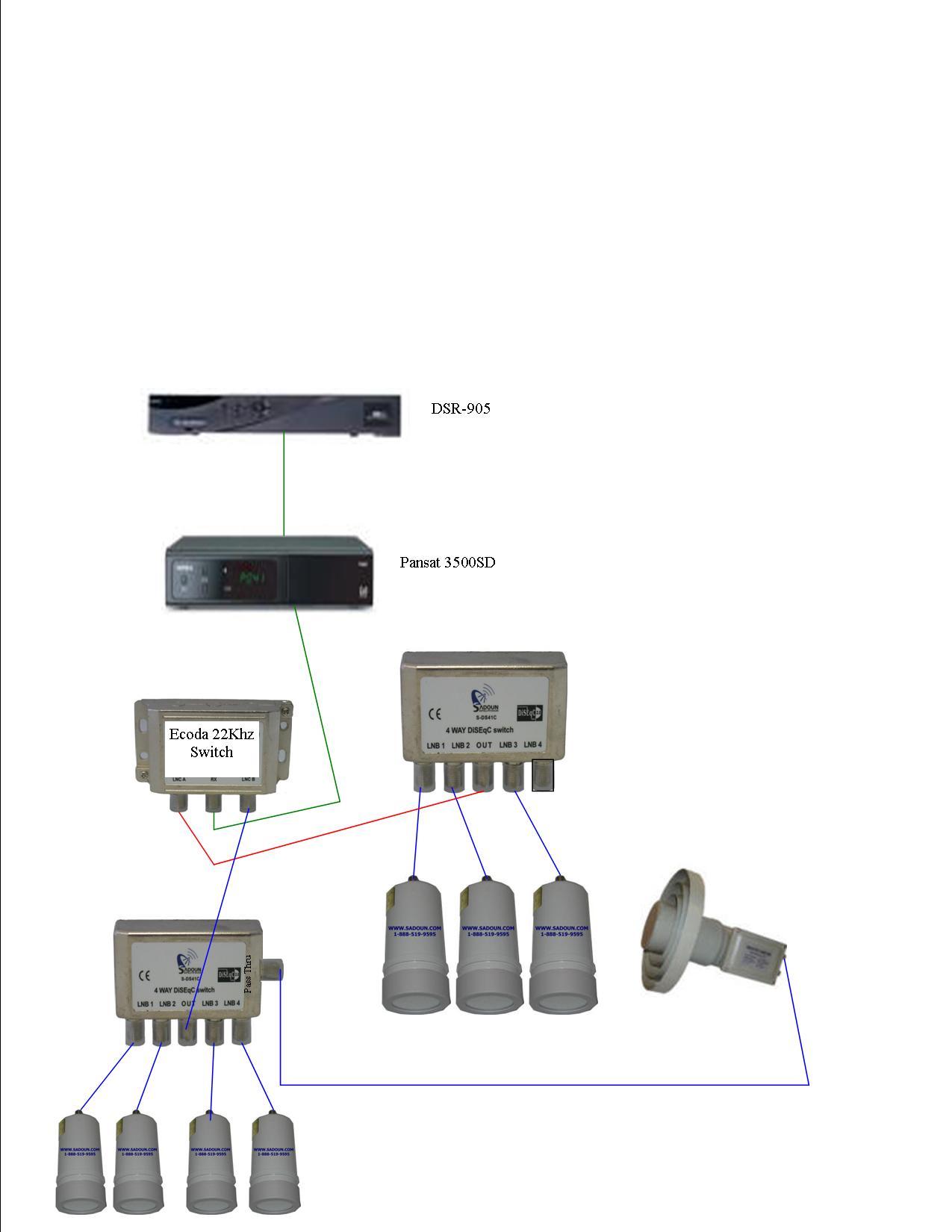

Ok, one more stupid question, does any company make a 4 way Diseqc with a pass thru so that I could use the pass thru for the C-Band LNBF and still have 4 other inputs available?
In other words use the non-22khz side of the 22k switch to connect to another 4 way disecq so that with no 22k and no disecq selected by the receiver then it would default to the C-Band LNBF.
Would a splitter work for this configuration?
Have you tried connecting the C Band to Port 1 on the DiSEqC Switch?
Maybe the DiSEqC Switch will "default" to Port 1.
That would leave 3 DiSEqC ports open, and could be expanded by adding 22KHz Switches after the DiSEqC Switch.
