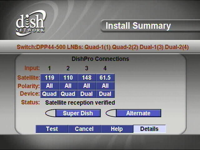

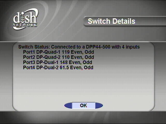

thanks for all the replies so far! I want a ton of information to bombard my installer with so he will believe me that I can get 4 satellites on my system.
So, keep all the replies coming, and if anyone has a tech diagram or installation photos... nuff said?
Here is a couple of screens you can show your installer.

One also needs to keep in mind that the SW-64/SW-21 (SW21-4 SAT) setup may not work with all receiver models, especially the very old models. Only some (many newer) Echostar receivers have support for this config.
I can confirm that all four sats do work correctly with the legacy SW-64/SW-21 (SW21-4 SAT) combination on my DVR 921 starting with L215 software. It was problematic with earlier software versions though. This configuration also used to work correctly with very minimal issues on my 811 until I replaced it with the 921. And this also worked with my model 6000 receiver, though the 6000 used to give an occasional check switch error which you could ignore by pressing <ok>. I do not know if this has been fixed now as I sold my 6000 about a year ago.
A 501/510 used to be problematic with this SW64/SW21 config in that at times timers would not fire if the receiver was turned off. But again this was a year or two ago. Not sure if this has been fixed.
So going with a DPP44 or a SW64/21 would depend on which receiver models you have, and how many recievers you want to see both 148 and 61.5.
If you want voom HD channels plus your must carry locals from 148, a SW64/21 should work ok on the HD receivers. If you want sky angel plus your locals on all your receivers, you may have to try out the both SW64/21 as well as the DPP44 and see if there are any issues with your receivers.
With the legacy SW64/21 configs, I would recommend putting 119 (1a/1b), 110 (2a/2b) and 148 (3a/3b) in that order on the SW64, and 61.5 by itself on the SW21s. Or you can put 119 (1a/1b), 110 (2a/2b) and 61.5 (3a/3b) in that order on the SW64, and 148 by itself on the SW21s. Other combinations could be more problematic.
If you have dual tuner recievers, both tuners must see the exact same config, or else problems will result.
And remember to check the "superdish" option when running check switch with the SW64/21 config, or else it will not work.
Hope this helps.
If you have a model 2700, 2800, 3000,3700, 4000, or any DishPro receiver, it should work as long as you have the most recent software. The 3000/4000 receivers will not work with a superdish, only a Dish 500 and Dish 300's (they cant receive the FSS signal from the 105/121 satellites). The problem with previous versions was that the receiver would see duplicate channels on the 61.5 and 148 satellites and the guide would get seriously messed up. The latest version handles any conflicts taht may come up.
