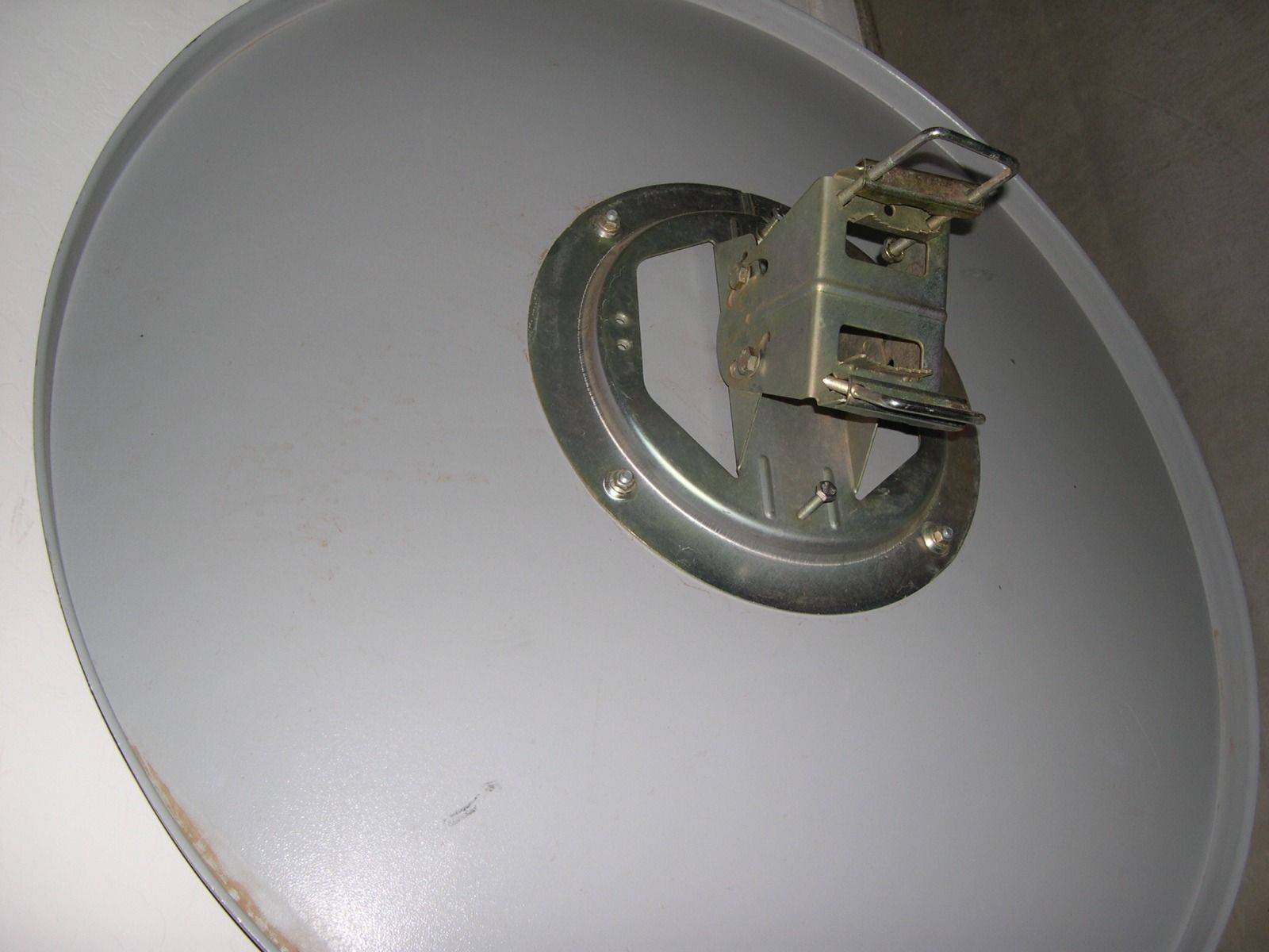

I bought this 1 meter dish but didn't come with LNB arm and I am trying to find what type or the manufacturer on it so hopefully I can find the part I am looking for.
There are no stamps or tags on it except a small tag that says "made in Englan" and I am hoping with the attached picture someone can identify the dish and help me out otherwise, I probably need to throw it in the trash..

It looks like a prime focus parabolic designed to be one half of a point-to-point terrestrial microwave link.

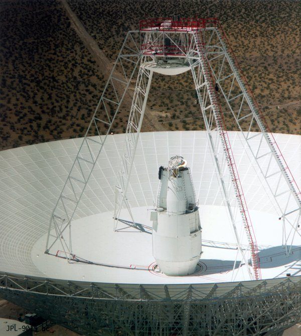

I'm guessing the one you are coveting is a Cassegrain setup. The cylinder in the center would be the secondary reflector, feedhorn, and LNB assembly. (Assuming it is the receive side of a one-way link.) The LNB points outward, sort of like a T-90, but the reflection path is coaxial, rather than offset as is the case with the T-90.
Attached Image: a much larger example to illustrate the concept
