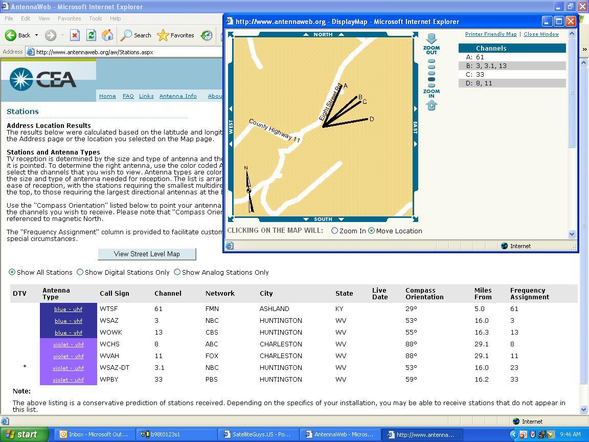

My antennaweb.org information is attached in a jpeg image. (My address is not accurate on ANY internet map including this and I always have to tweak it)
I could get all the networks (3, 8, 11, 13 for me) in digital but they were very weak and I had to move the antenna around each time.

A lot of factors can affect your reception. If you are looking for an antenna just for digital reception you may want to consider a UHF only antenna. It looks like all of the digital stations in your market are UHF. The last information I could find didn't show WOWK as being up to full power yet. If you were able to get a weak signal for the stations you wanted with the VU90 I would upgrade to a more powerful UHF antenna. Then try to get it as high as possible. An amplifier would help, but you need to maximize your signal with a higher gain antenna and possibly height before that.

You have digitals out of Charleston and Huntington as well as Portsmouth OH, but your location appears to be in a hole. Moving around you with the antennaweb map east about a mile all the stations suddenly become yellow.
Get that antenna HIGH UP there and you just might strike HD.
I'd go for a CM4228 with a Winegard 269 preamp, or an Antennas Direct 91XG with same preamp. Mount a 40' telescopic mast on top of the house and stick that baby WAAAAY up there!
If you get signal, add a rotator for Charleston (East) or Portsmouth (NW).
