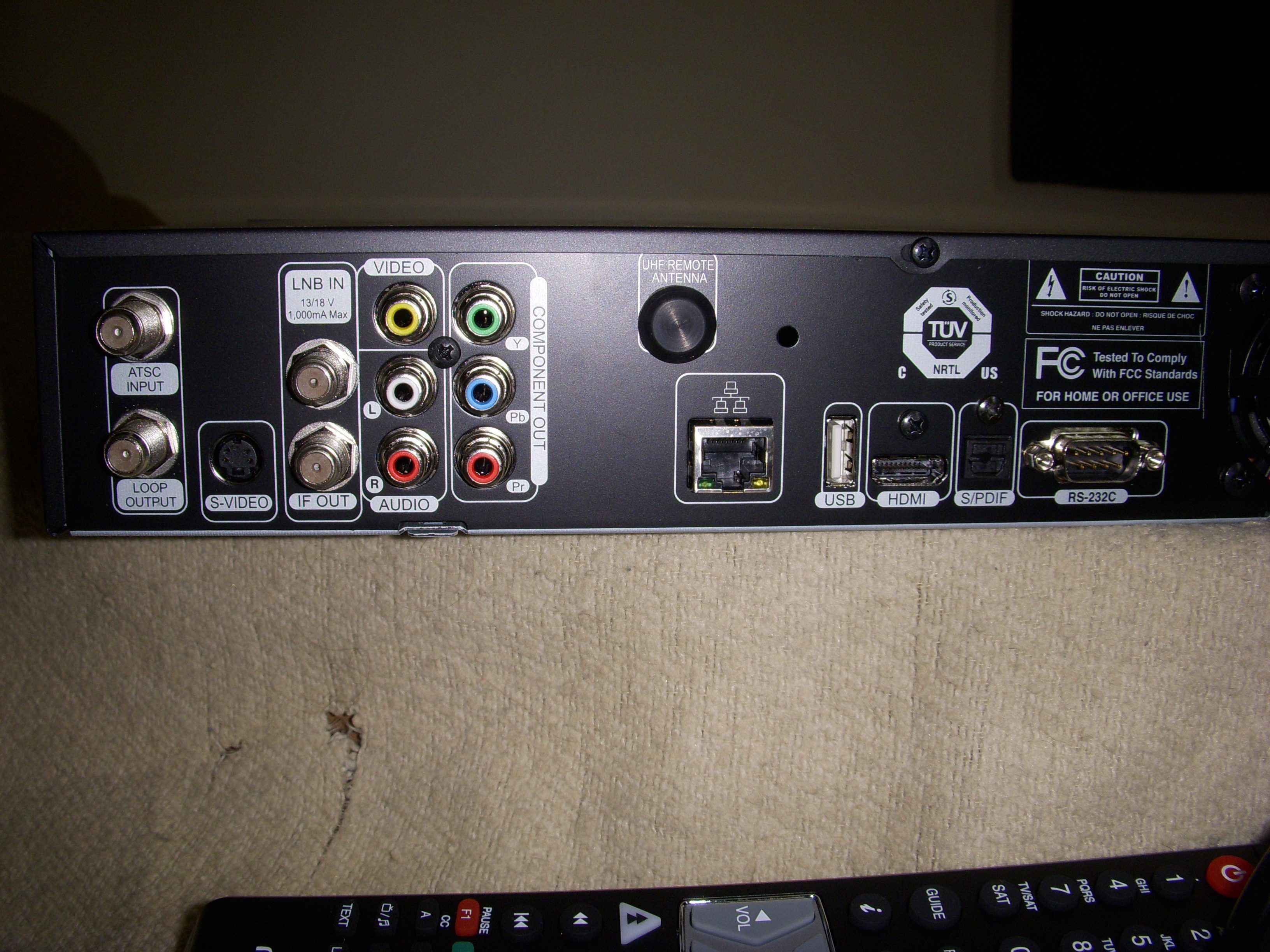

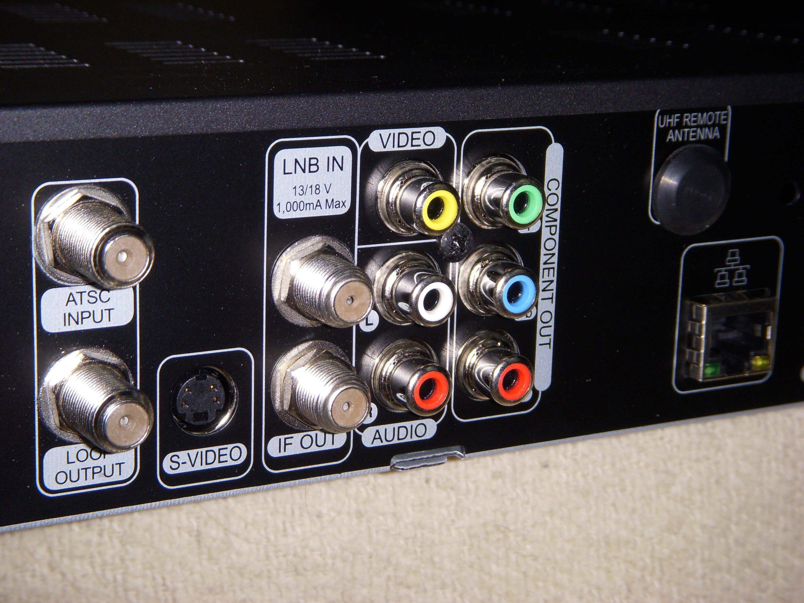

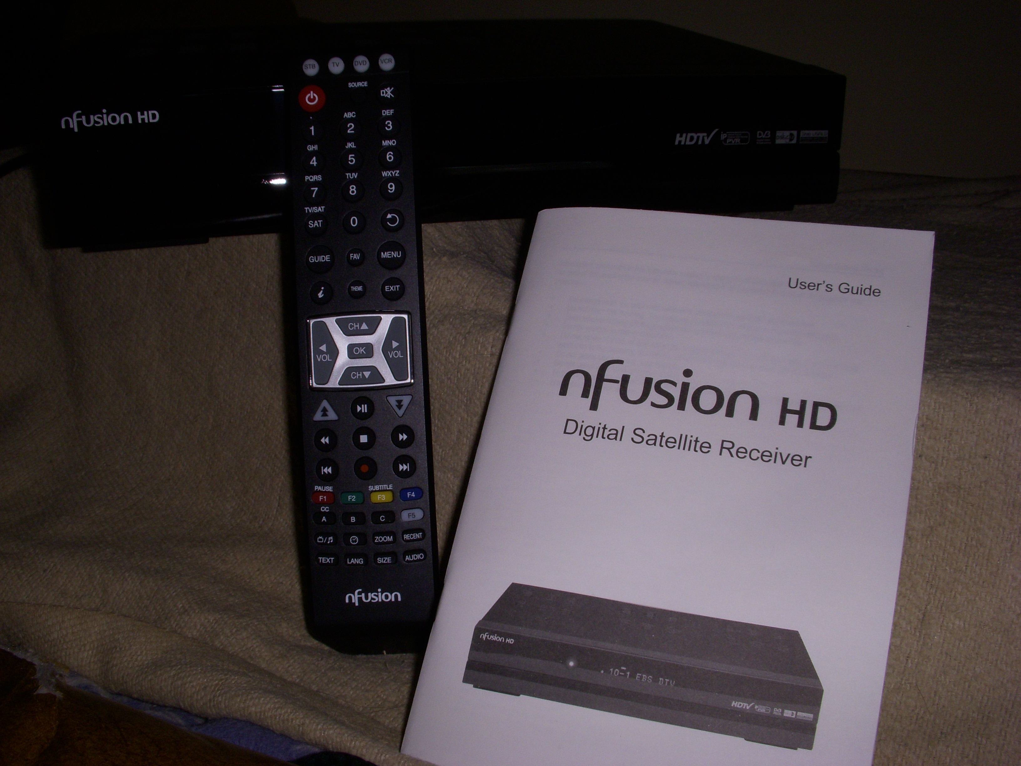

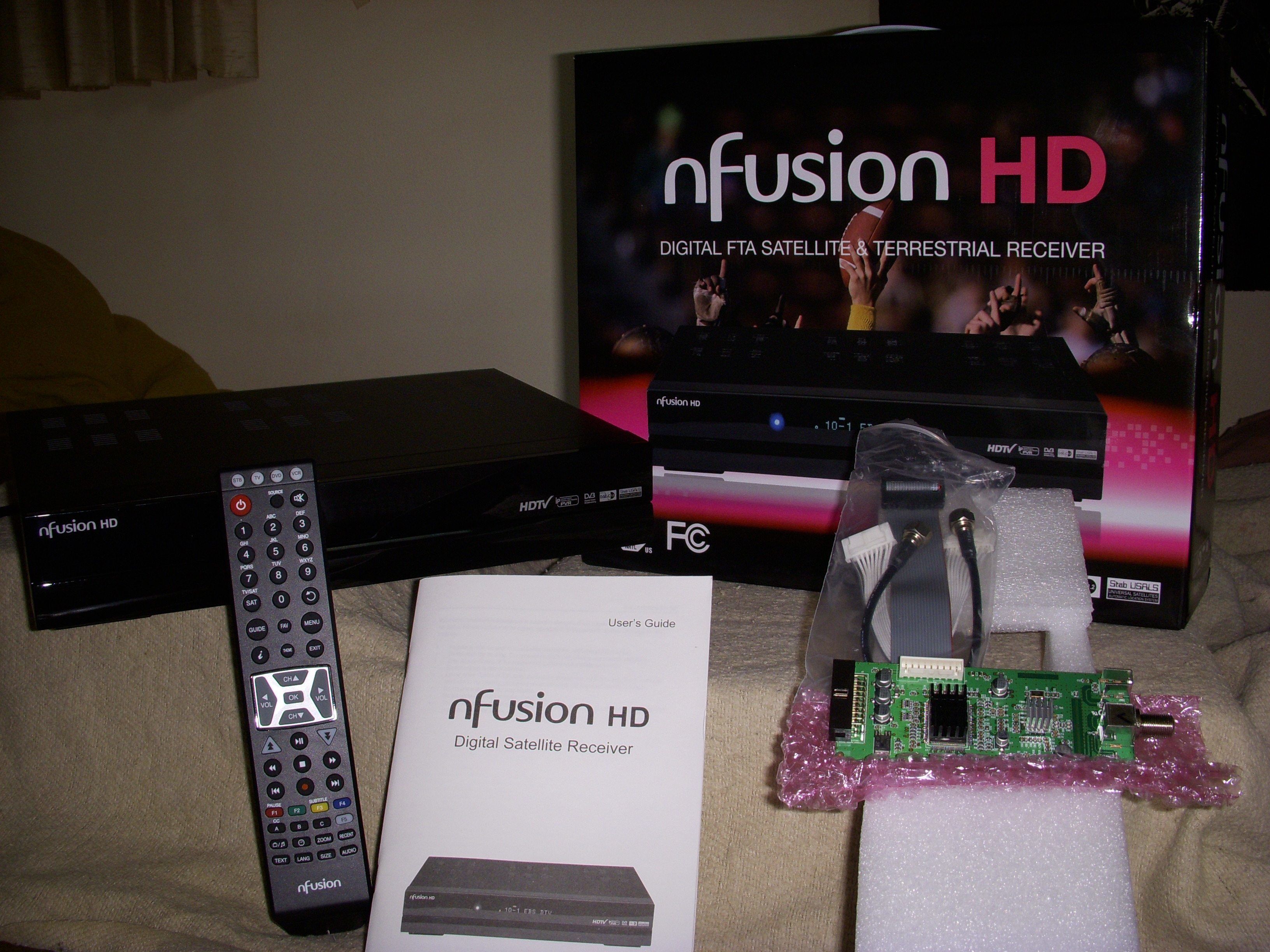

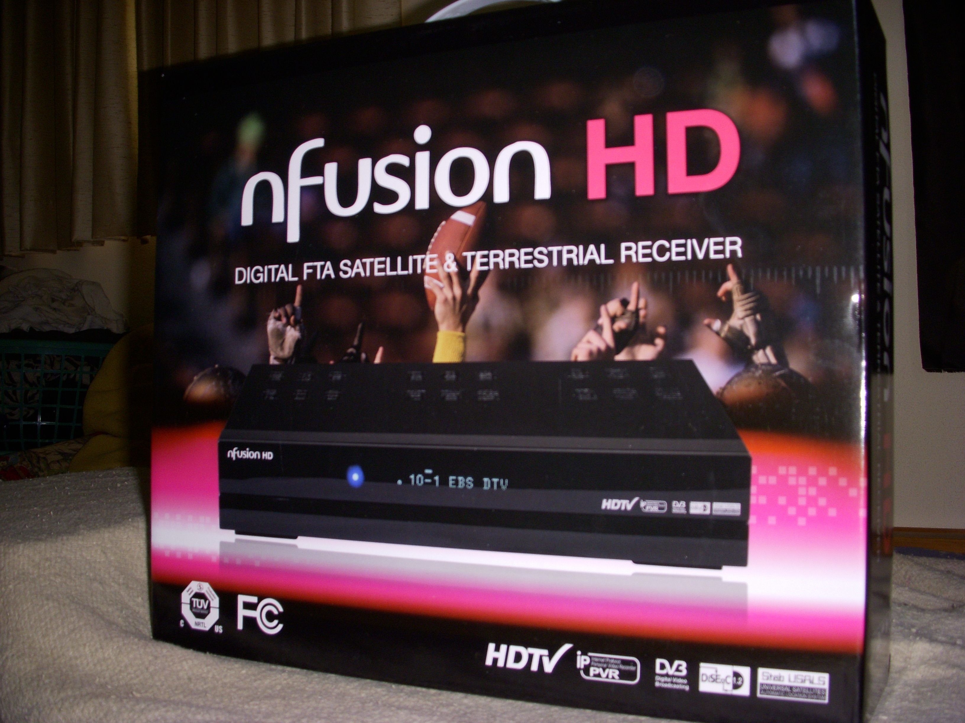

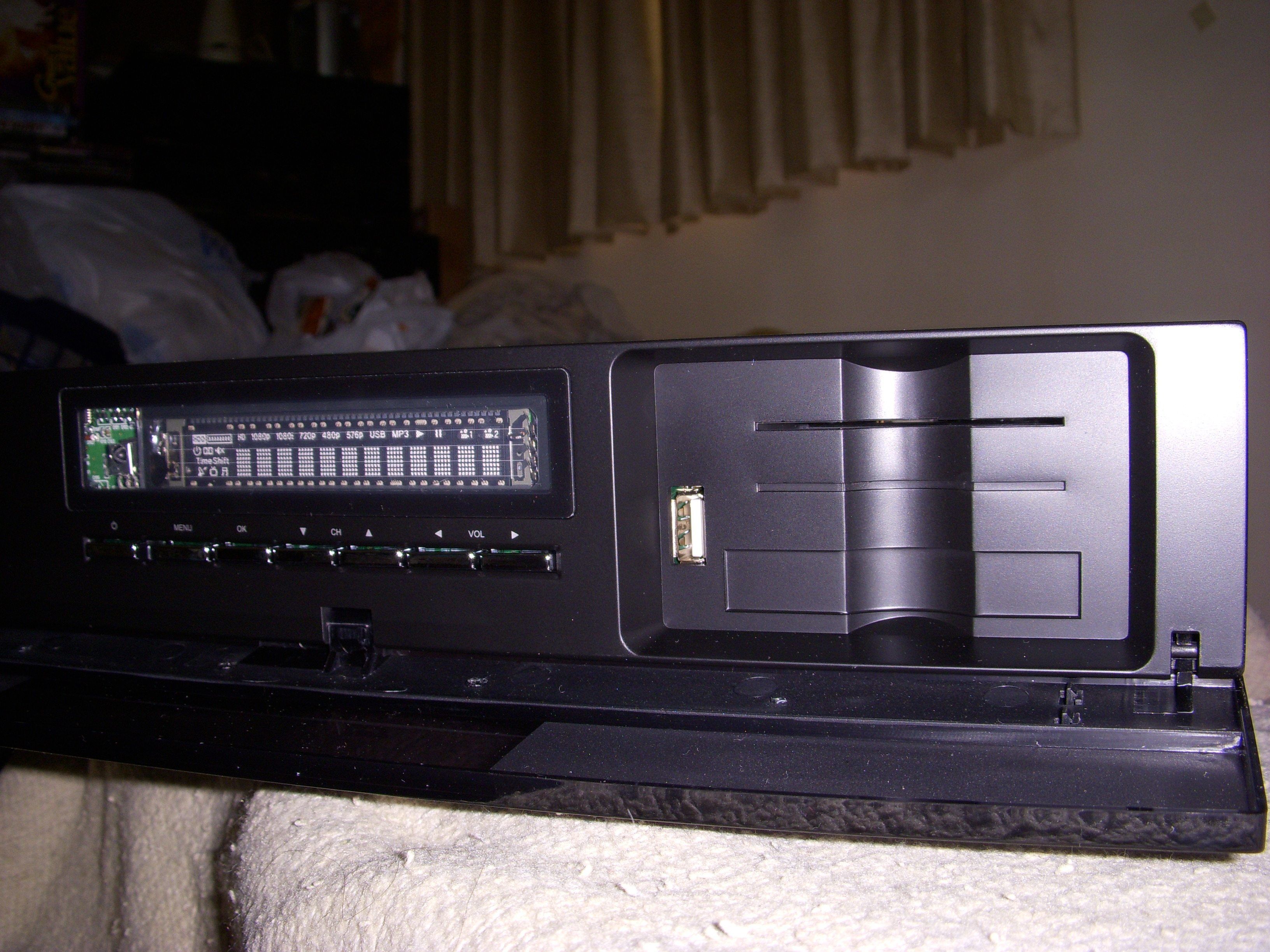

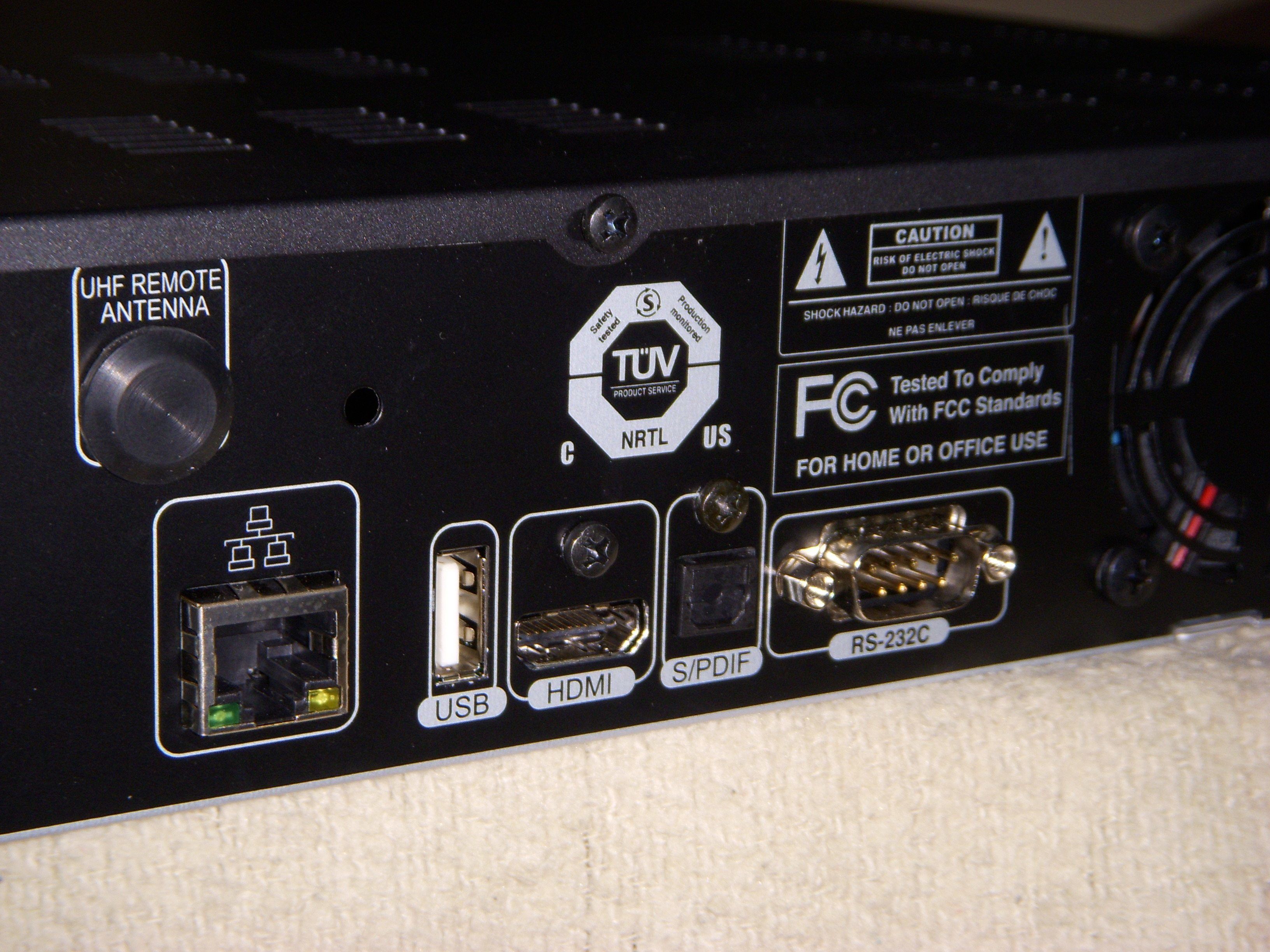

Here are some pic's of the Nfusion HD FTA receiver. hope they come through.

will post more pic's when I install the 8psk unit.
I hope you know the Nfusion is a iks pirate receiver, the board is most probably to pull in Dish nets patented turbo fec feeds, I would have to say the dish and motor are great but you should have reviewed receivers a bit more before purchasing.
turbosat, will be working on putting the dish and other things up in the next couple of day's. Everything I need came today.
tdti1, I did look into the receiver and what you are saying is true but wanted something different. I thought about the Pansat 9200 HD but went with the nfusion.
We'll see what and how well it work's sometime over the weekend.

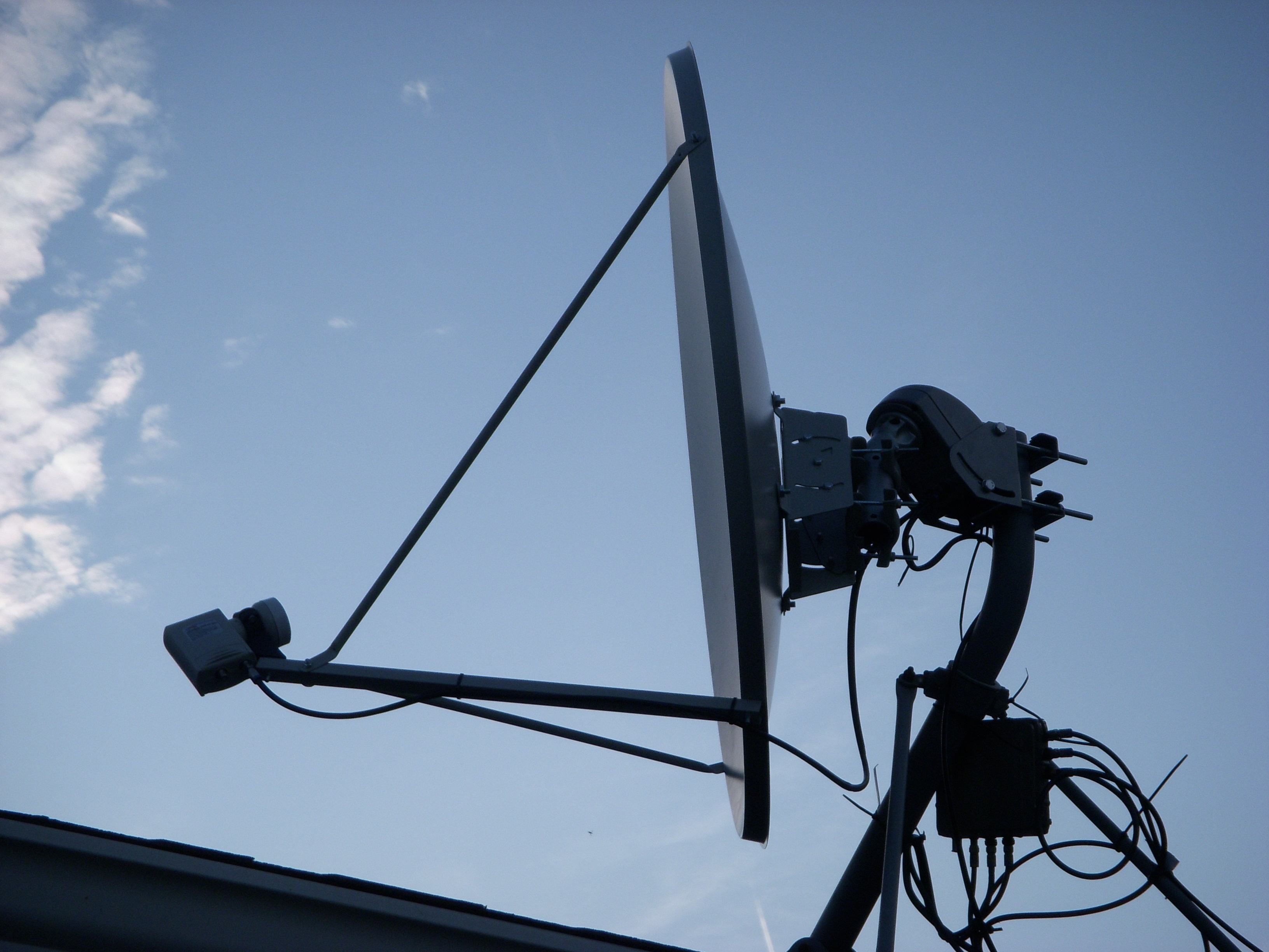

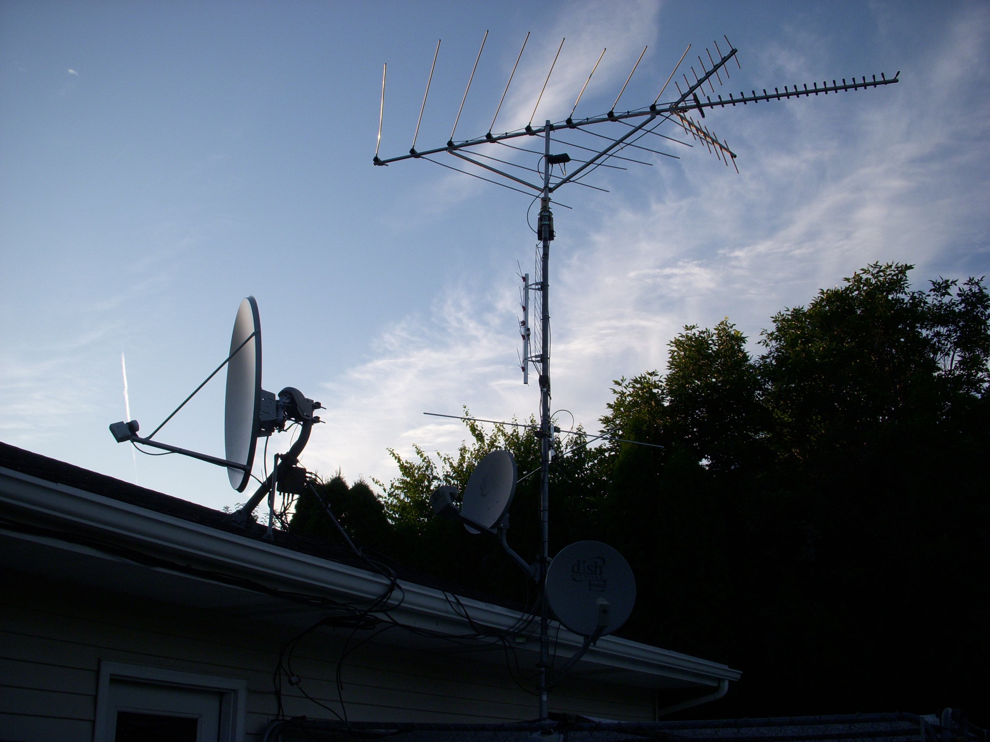

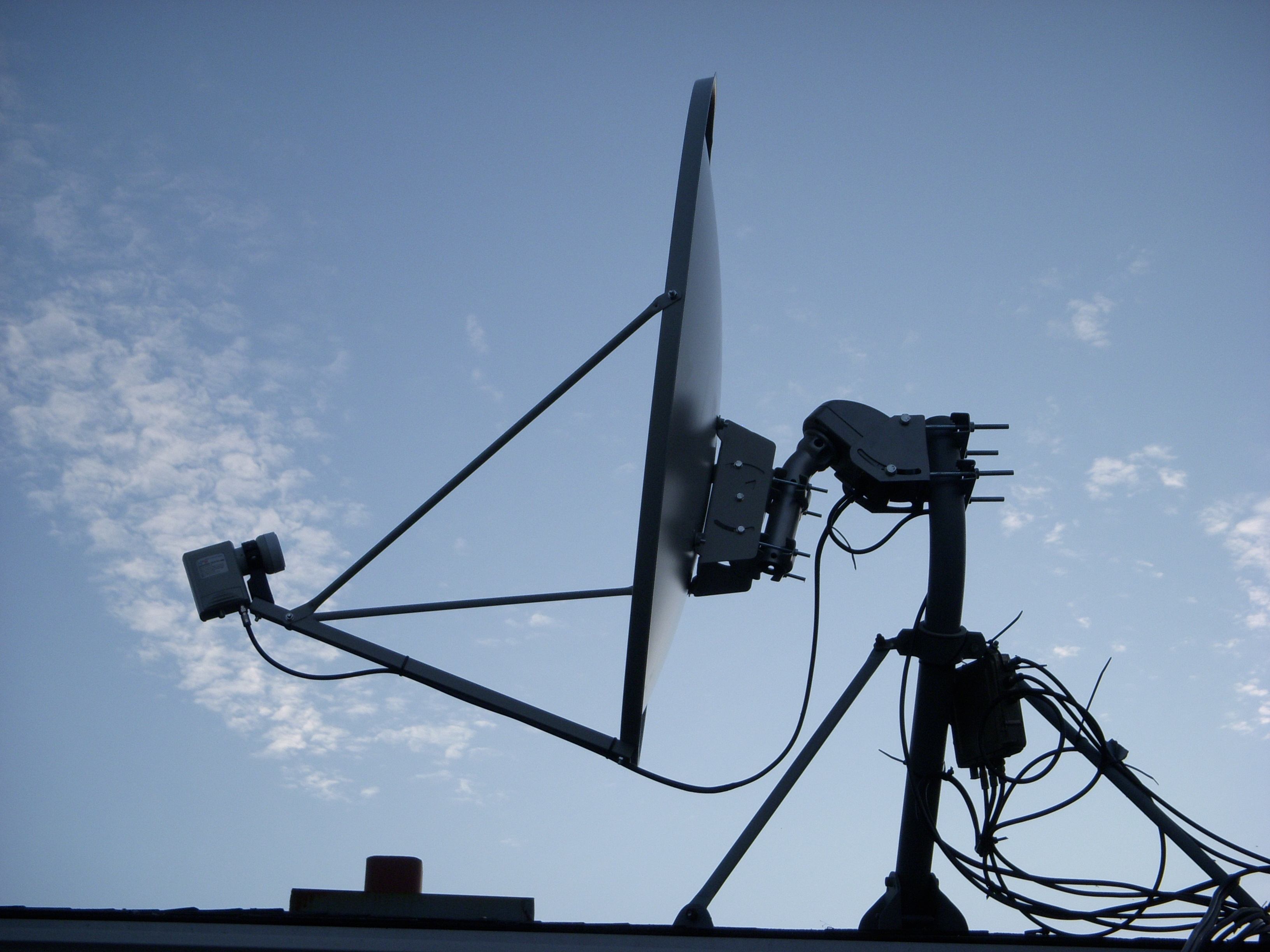

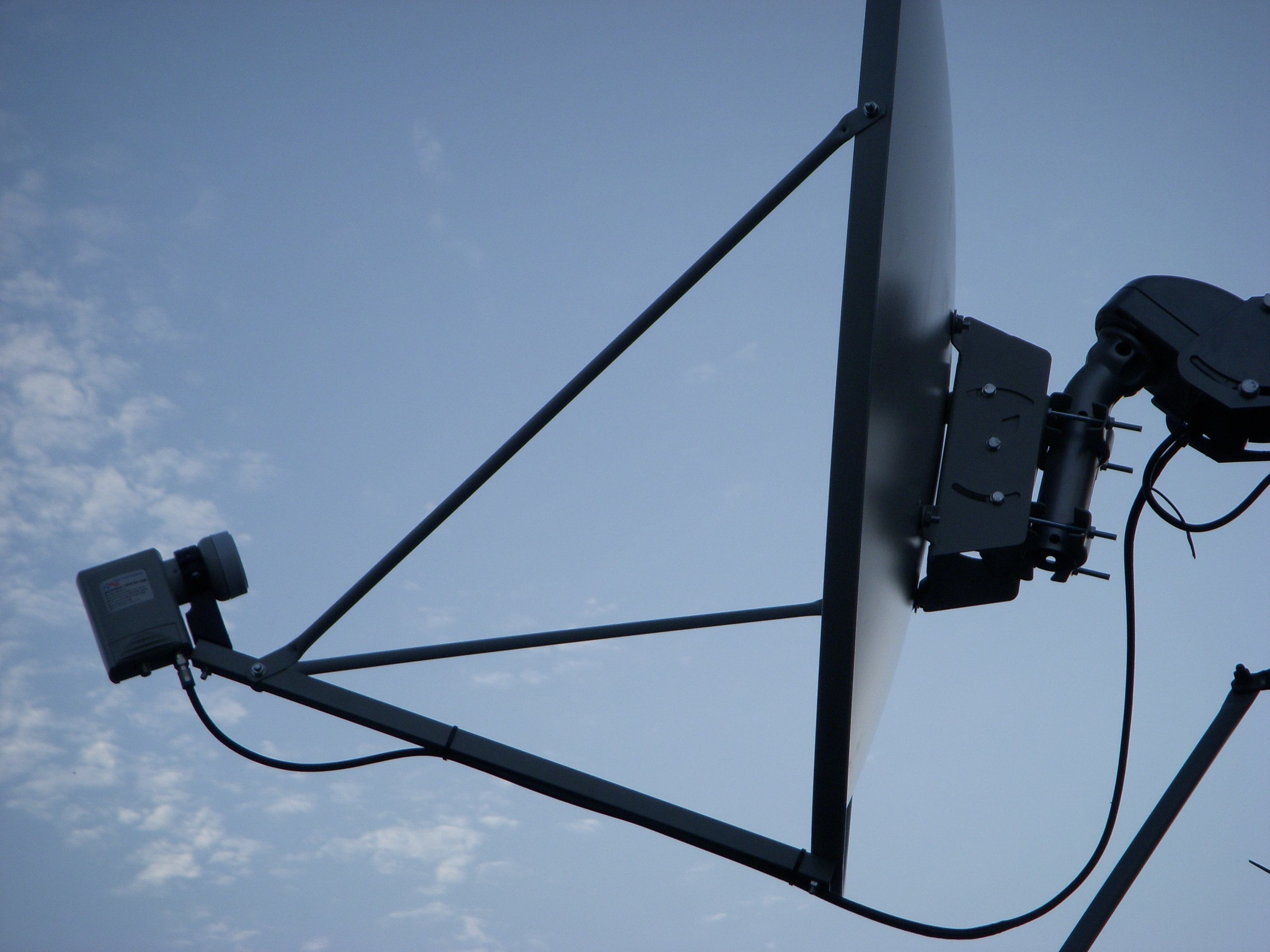

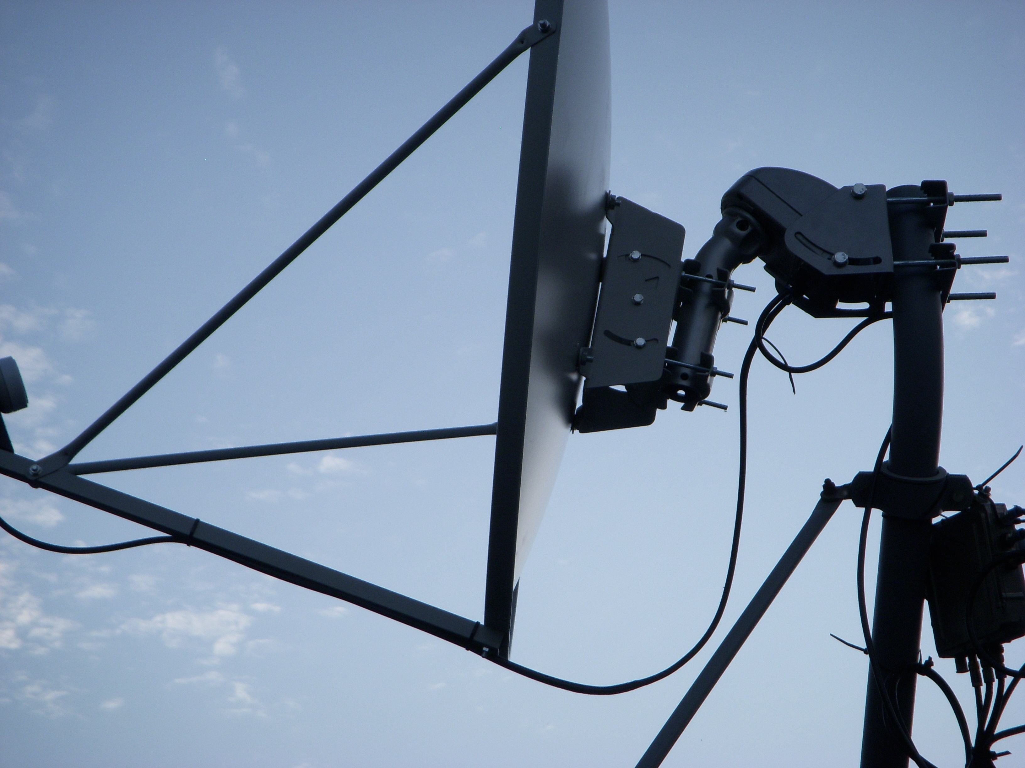

Well got everything up now and now is where I need some help. The motor will not move, it does have a Reset Button on it also I'm not sure about the Elevation is right will get some pic's to post of the setup.
Lat 88.7 Lon 43.2 Motor Elv. 43 Declation is 6.6 so does that mean the dish elevation should be 36 cause some web things say 23. so any input will only help.
Musher
Update: The Motor is now moving east to west and back but I think it is the Elevation cause I'm getting some signal strenght of 37% but no signal quailty. I did get some pic's The Motor move very well using Diseqc 1.2.

You are where I was 2+ weeks ago, as it stands now I can scan from 82 to 119 and every sat in between.
There is an ark in the sky (sat position) that you need to match with your set up.
Envision a 180 degree semi circle going from east to west. now all those sats are along that line (that is why your truest south sat will have the highest elevation)
I know this may sound Greek now, but read and it will come to you, cut 2 180 degree semi circles out of paper, put dots along it ( to represent the sats) then miss-align those arks and you will see why you can pick up some sats and not others.
As a New Guy and seeing you have the exact dish I have, here were my down falls.
"True South" it's tough to find, setting the 30 degrees on the dish it's self and the elevation.
For me, I got closer to "True South" once I removed rare earth magnet (for RC planes) motors to the shed.
On that dish you have, to get it parallel, measure the distance from the back of the dish to the movable bracket on the top and bottom (making them match).
Once you have the motor at 0 degrees, you have to make sure the dish is at 0 degrees too. I measured from the side support to the back of the mounting bracket, I made both sides equal.
Now (depending on the rx), my Coolsat 5000 does NOT have the strongest transponders programed in to it, and when scanning for a sat, you may be looking for a frequency that does not exist on that sat, meaning you will miss that sat, read my son READ.
For true south vs elevation, if you can goto 82 and get a stronger signal when you put slight doward pressure on the dish,yet when going to 119 you have to use upward pressure then you know you are a degree or 2 too far to the east, YET if you have to use upward or down ward on both sats then it is a simple elevation adjustment.
I know alot to asorbe (because I'm still trying myself), stick with it as I found TODAY, I now have the widest range I have had to date.

Can you post your 8 psk board full chip models, as printed on its each chip?
