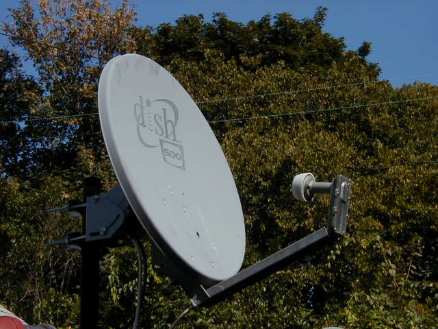

Maybe some are curious about what i mean by a dish 300/500, i just changed the deflector off a dish 500 and put it on a dish 300,holes matched perfectly no mods required. As they always say bigger is better!
That was my first attempt playing with motors.
The motor was a loaner I was training on and I had no big dish to play with.
The legacy 500 would only mount on a dtv 18" bracket, not dish 300.
Lnb arm distance was fine,quality was in the 90's at that time for circular sats.
Lnb was dtv type out of the plastic case.
