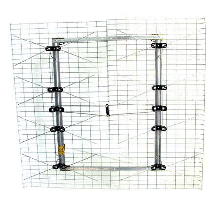

The DTV tech installed the antenna-I don't know the make and model of it. As I recall it looked a bit like a waffle (for some reason i think he called it a pancake antenna). Having all the locals except Fox is okay, but not perfect (need my football on Fox). Any idea on how to tweak my system to get it (without having to call DTV)? Thanks again for your help.
Does it look something like this? Bowtie Antenna.

That bowtie antenna kind of looks like that. I live in Bethesda, MD (zip is 20814). I'm interested to see how far Fox is from me as opposed to the others, since Fox is the one really giving me problems.
