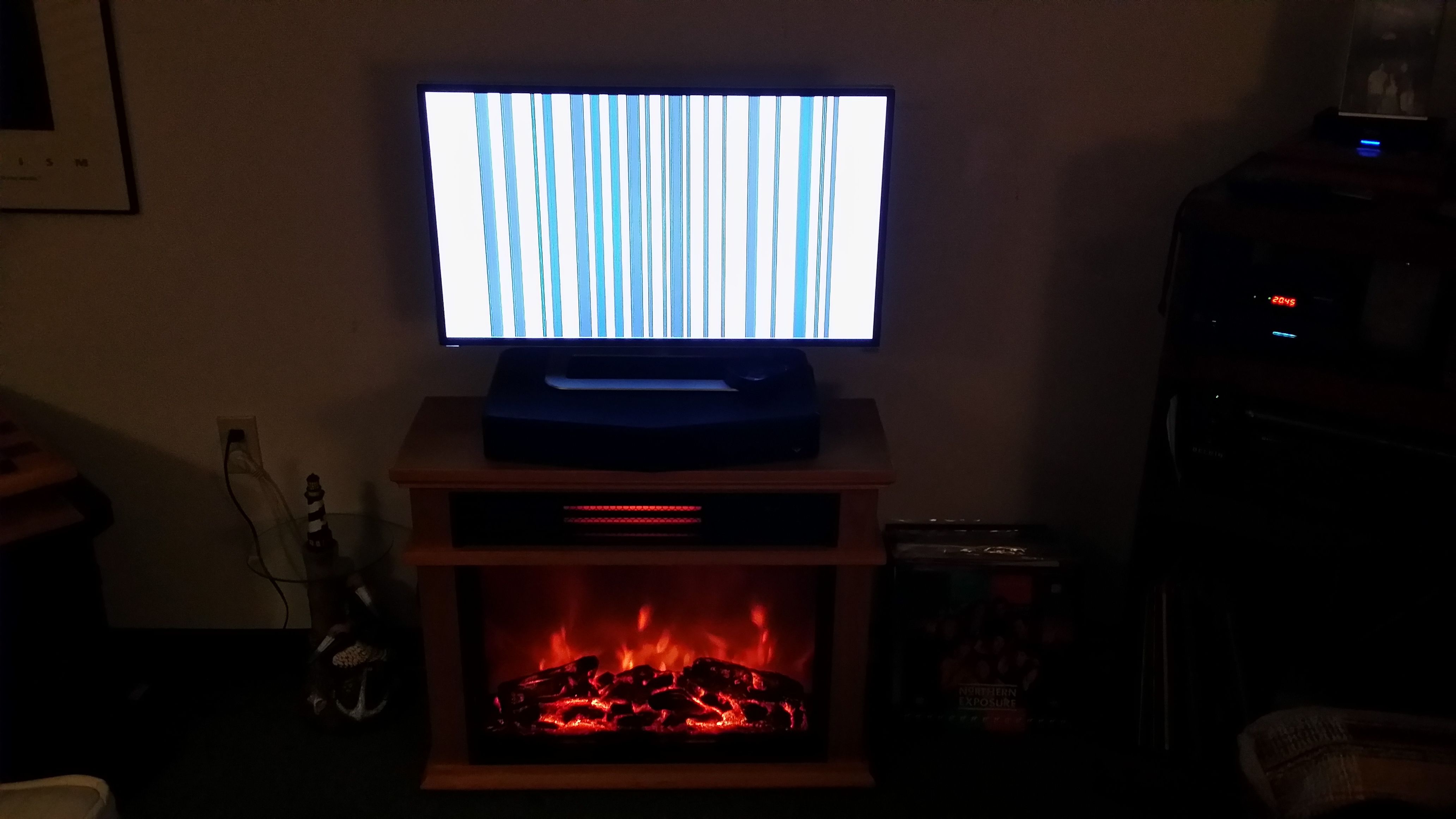

Wandering topic just a bit here, has anyone found that if they "ignore" their Amiko mini too long (a week or so)...with it "on" (not standby) that the clock freezes on the front panel and the video shown in the picture is rendered? It needs a reboot when this happens. Seems to be the answer to "life" lately....REBOOT. (though if you ask Amazon Echo what is the meaning of life, Alexa will answer, "42.")
By the way, the receiver is nowhere near the fireplace...so it's not heat.
No. I have two that stay on 24x7x365 and a third on part time.
Currently on v 2.2.14.
What is standby?
