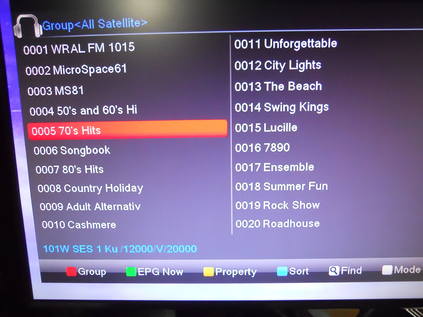

Ron_MNdish, you must be doing something wrong. I just downloaded the file, did a fresh install and its working with the Muzak Radio Channels on SES1 101.0W 12000 V 20000 just like it should. In fact here is a screen shot i just took (attached). You must download the file i attached, then using Winzip you must "unzip" the MINI 4K 1UHD V1.0.52 Muzak101.abs file to your flash drive. Insert that in your receiver. Then go to:
System
Software Upgrade
Upgrade by USB
Upgrade File > Choose "MINI 4K 1UHD V1.0.52 Muzak101.abs"
Upgrade Mode > Choose "All SW + Boot Loader"
Hit Start
After it loads and re-boots you will have the Muzak Radio Channels like show in my attached picture
