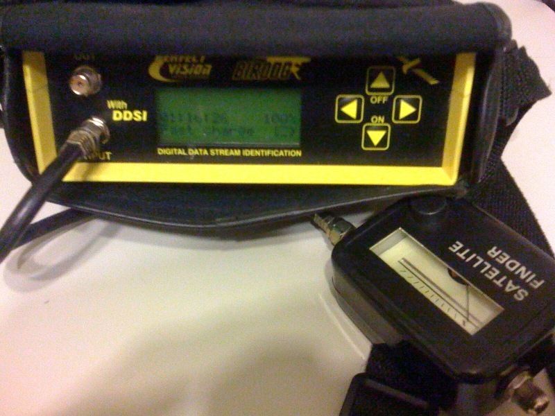

Well, yes, and, no.
I tried to used that fancy-schmancy new La-de-da meter but to no avail.
I ended up putting that little cheapie squeal meter my neighbor gave me.
He had previously taught me how to use it. So really the fancy meter was just giving power to the little squeal meter.
I don't think I have the birdog programmed properly, yet. I'll have to try different options then save the settings that work, now that I am totally on the right satellite. I don't know how that dish moved but it did. It was tight on the pole, I had to use a wrench to adjust it.
It's also very touchy about clouds. We have been having a lot of nasty weather lately and the picture goes in and out. I can look out the window when the picture goes out and see dark rain clouds over head. As they pass and the sky opens up again the picture comes back..
As for the 100 / 100, well that's dropped down to 90 / 100 now. If it falls below 80 / 100 the picture starts going on and off. How it's getting these numbers I have no idea, it's what shows up when I press the info button on the remote.
I'm thinking that I may have better luck when (IF) I can ever put up that big dish on a motor. This stuff is soooooo touchy. Rain or even rain laden clouds really mess it up easy. This is definitely a clear skies only project. :rolleyes:
Oh, I looked at that dishpointer.com site and there are trees dead square in the way. And they are well within the neighbor's yard, they are HIS pecan trees. I dare not touch them. All I can do is hope that the next hurricane takes care of them. He's a nice neighbor that brings me BBQ plates sometimes. I like the free BBQ. I will leave his trees alone. :)
I think though, that there is one other thing I can try. I'll get back with you on it. What's on that satellite anyway? It sounds like Spanish, which I don't understand, I'm a mono-language girl. Never took other languages in school, back then they were optional.
