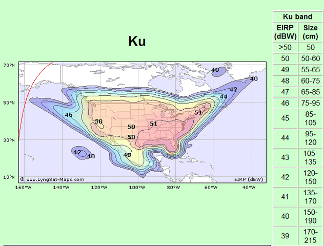

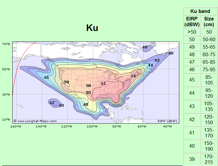

My location is outside of Nashville, TN. I also would like to get RTN, which I gather is another issue with signal strength. I would need a motor to change satellites.
RTN on 83W has been a problem for me, but I think that is a problem of my own.
You are in a very good location for this satellite. I attached the EIRP map for 83.0W
You are in the "HOT" zone for reception from this sat. 51 dBW. Which means that a 50 cm dish is minimum required. The dish you have is likely larger than that so you should be well set up.
Some people have been saying that a one meter is the way to go for RTN. I get an acceptable signal from my 90cm motorized dish in New Mexico.
Yes, you would need a motor to span those two birds. Either that or two dishes.
