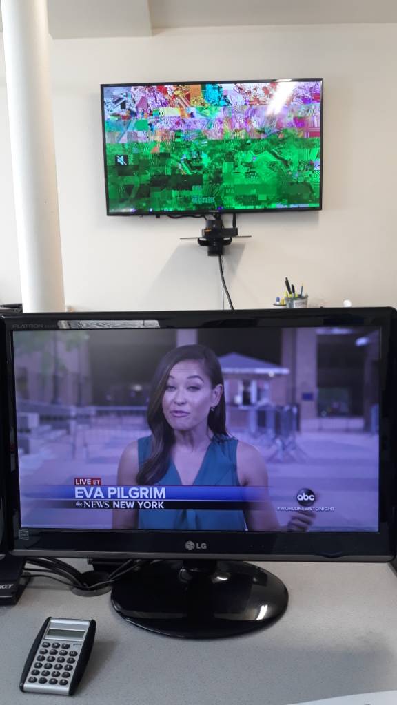

Is your computer connected to the internet? If so, you have everything you need to play 4:2:2 on your TV.
Now all you need is a DVBS2 h.265 (HEVC) satellite receiver that streams.
The point of my posts about watching the 4:2:2 services is that 99.9% of us already have a computer, smart phone, tablet or android STB that has the capability to play 4:2:2 live or recordings...
I've got computers out the wazoo, I may play with this a bit to see what happens. My STB does streaming, but I'm not certain I can keep enough bandwidth to stream it. When it works right, I'll have 16mbps or more, and other times I may have .5mbps. It's a really sucky wireless service. Unsteady, low uploads most of the time and goes off at least once a day, but it's all that's available 10 miles from town. :(
Streaming from the STB to another device on your network has nothing to do with Internet speed. Your router shares the connection between the STB and the playback device on your local network. No Internet connection is used or needed to stream the STB channels to another device on your network.
Reactions: comfortably_numb
Steaming 4:2:2 Works Great! :)
Reactions: FTA4PA
