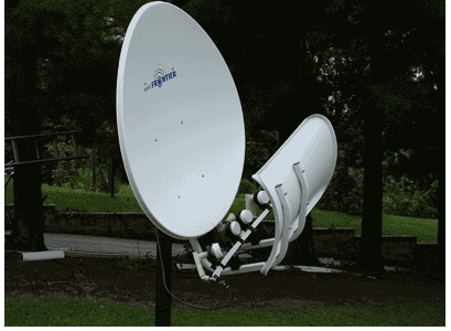

Screenshot_1.pngThe only solution that would work for this is a toroidial dish. Rather espensive but it is advertised to cover 40 degrees of the arc. This dish is popular in Europe. You can get more information here> http://www.wavefrontier.us/

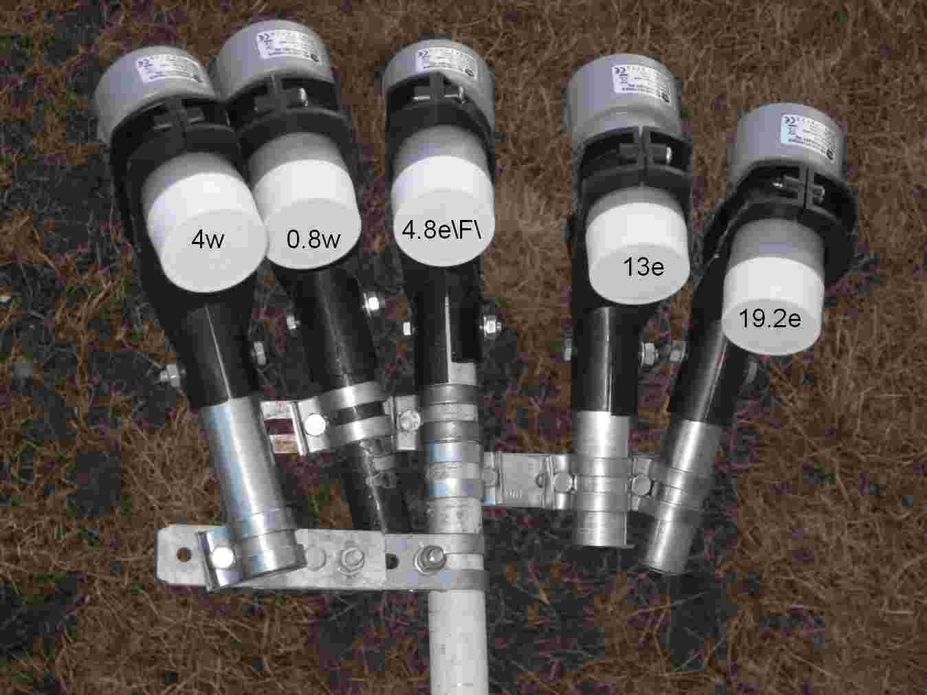

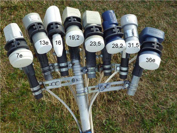

Good evening.
Reception on one Dish some companions at us in Europe very much practises. At me it is established Dish on 1,2 m Offset so on it perfectly go 8 satellite. And from focus 19,2e to 36? - 17 degrees and a signal excellent on 36?. On Dish offset 0,9 m 4,8e/F/-19,2e - 14 degrees.
The only solution is to employ a bigger dish, to hopefully get enough signal to the feed, with offset feeds, or separate dishes.
Employing an elliptical, could conceivably work. But each, 97 & 125,(Again IMHO) would have to be 'offset'. The dish would have to be 'boresighted' on a satellite midway between 97 & 125. Like 111, Then each LNBF (for 97 and 125) would be offset by 14°. Another thing to consider is the 'skew' of the arc. The dish should be skewed to the skew of the 111 satellite. Not just the feeds to the satellites being attempted.
-FaT- all is correct. I would advise eksperement - on Dish 1,2 m.? focus to put and adjust on 113,0w, well and then along the edges 97 and 125w. Signal on these the companion excellent.

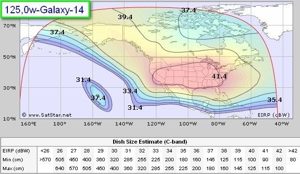

http://www.satstar.net/satellites/sm6.html125w-C-.jpg
I'd experiment also. First by aiming the dish directly at 125W and recording my Q readings. Then aim it at 113 or 111, then try to get 125 with an offset LNBF. The cost of it is only a bracket, switch, and LNBF.

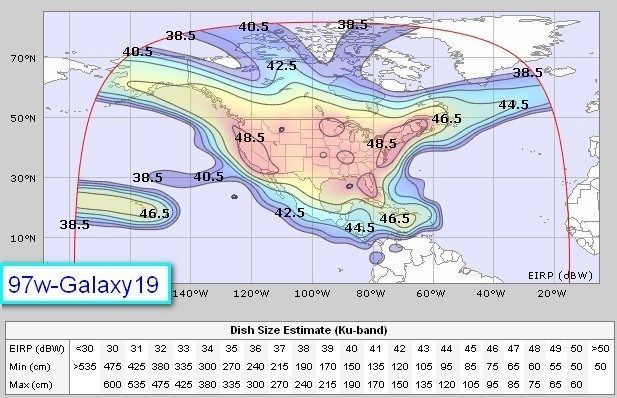

Just don't know if a 90cm dish is enough as performance will 'fall off' with the offset feeds. So the performance is comparable to what? A 70cm? I get squat, "0", on 125w with a 70cm aimed at it. That is what concerns me with the espectation of success. But the 84e works very well 'boresighted'**. The maps above show that 125W is some ~8db weaker than 97W. That's quite a 'bit' I feel. The only solution, I see, is at least a 1.2 meter with offset lnbf's. If determined to go that 'route'. But 1.2m dishes are $$$(with shipping)***.

On another topic: God man, aren't you worried about starting fires with those eirp values?
http://www.satstar.net/beams/astra4a_eurb.html http://www.satstar.net/beams/amos3_eurh.html
Average ~10db stronger than anything this side of the pond. That's big time strong. just put a lnbf on a funnel??
The DBS satellites spot beams may be that 'hot' here, but not FTA, and they can be had with a 50cm dish.

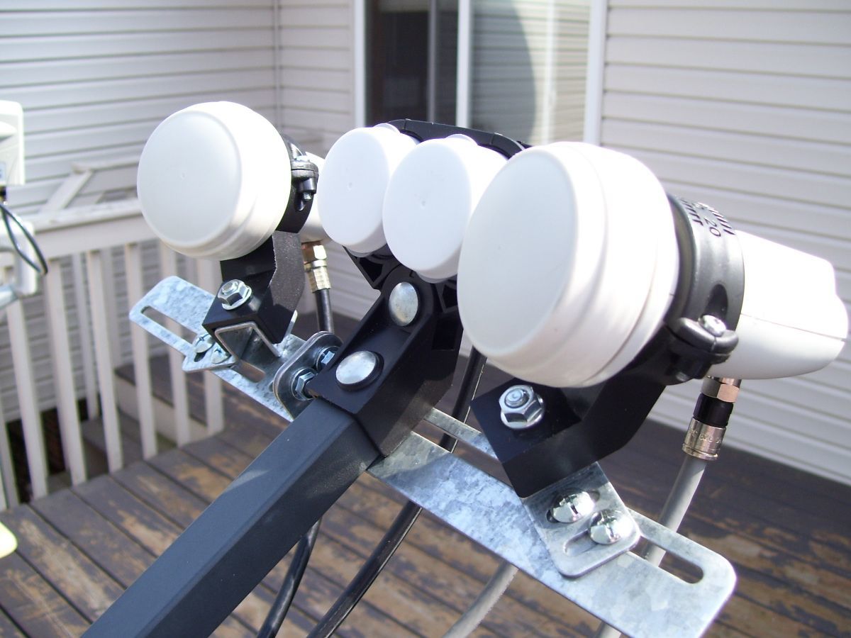

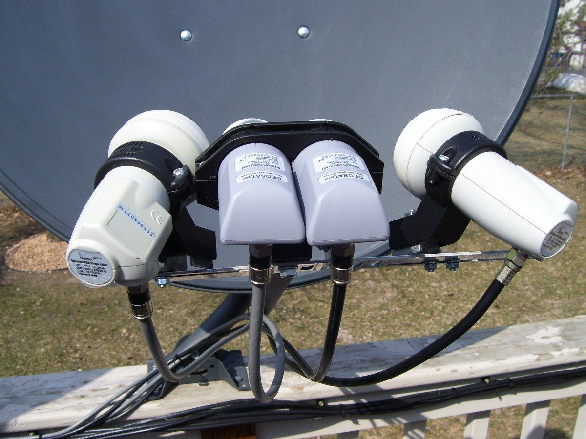

agreed with the above. Best I did at one time (other than the Toroidal) was 89/93/97/103 on a 36" dish so about 8 degrees each side
Lets see if I remember the setup
89 had ABCNewsNow and sports feeds
93 had Doc Scott (University Network) and feeds (this is before the satellite there had major issues and was partially replaced)
97 for obvious
103 for Pentagon (couldnt get anything else and this is when it was just the NBC feeds.....not the "cozi" stuff)
