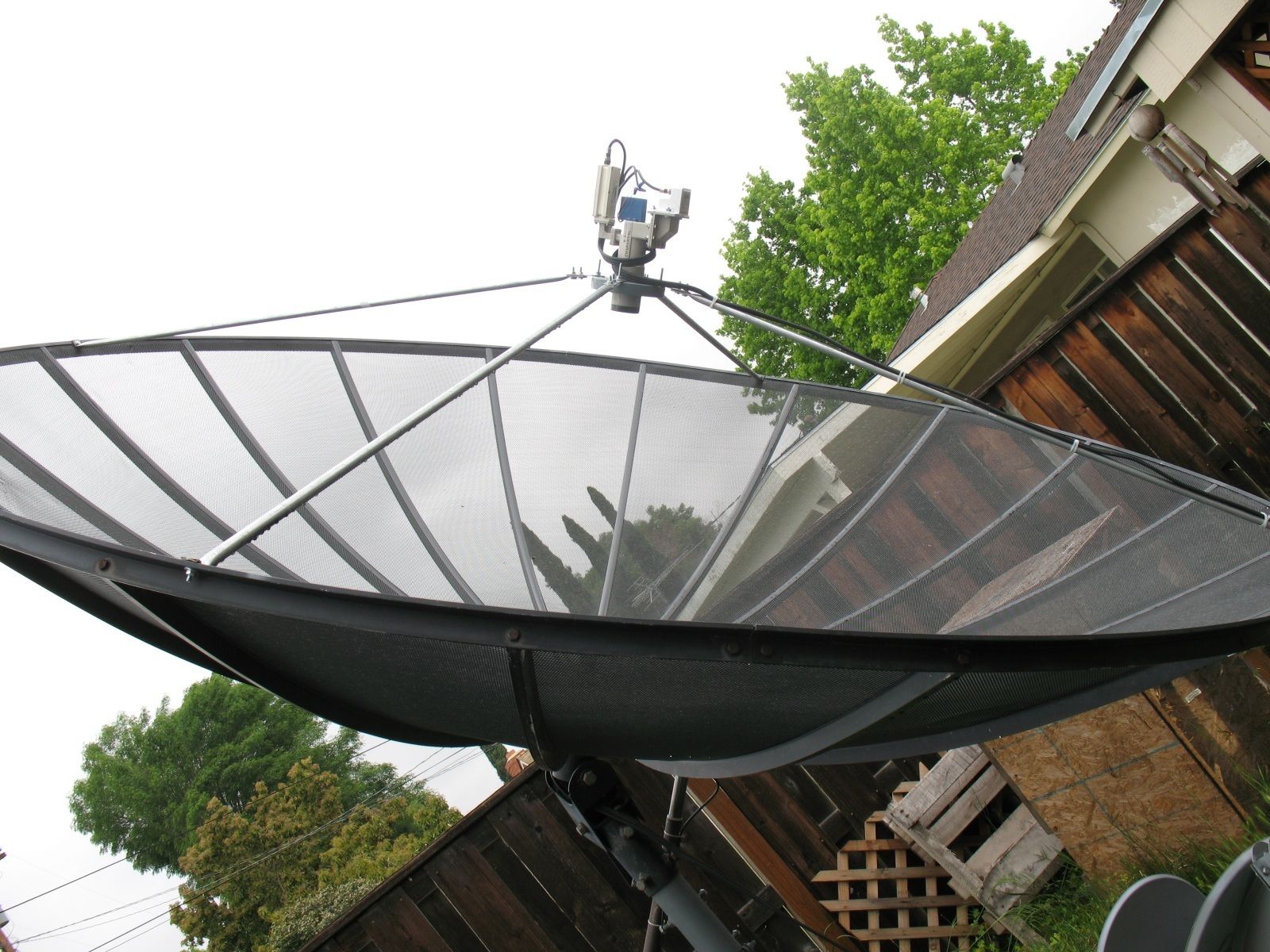

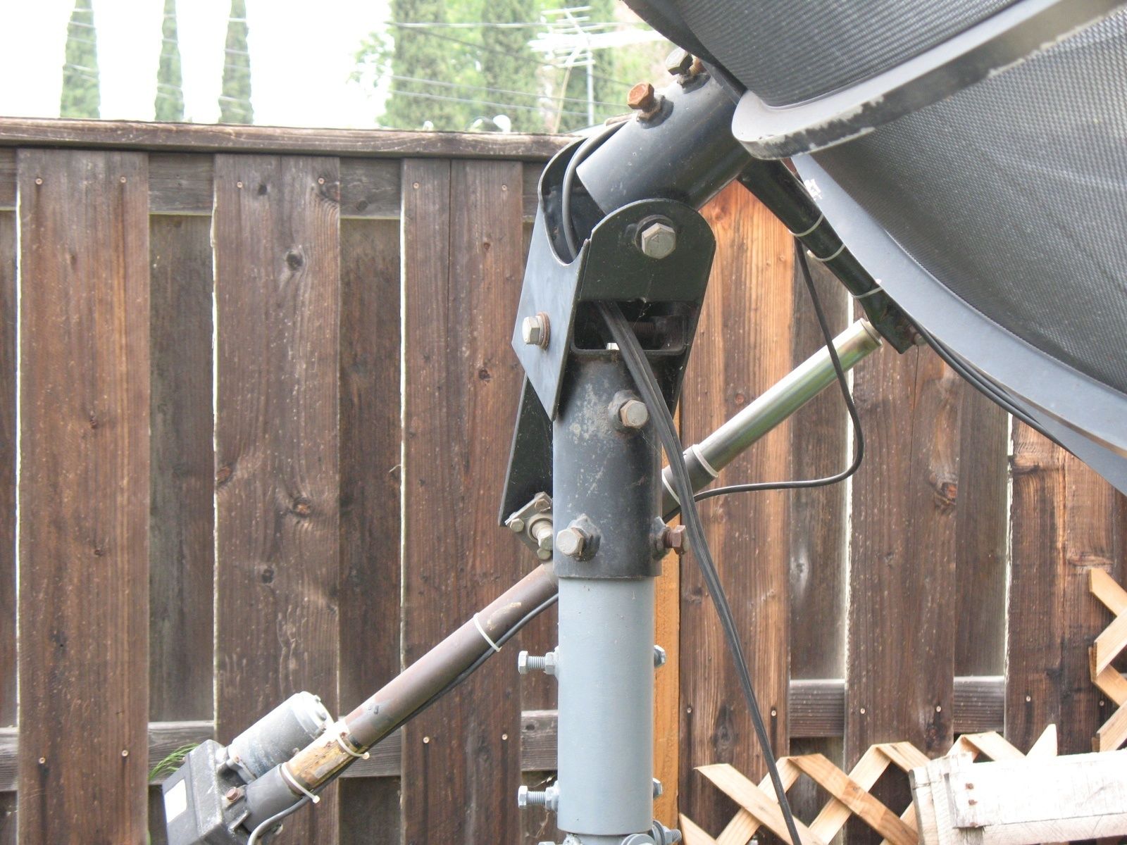

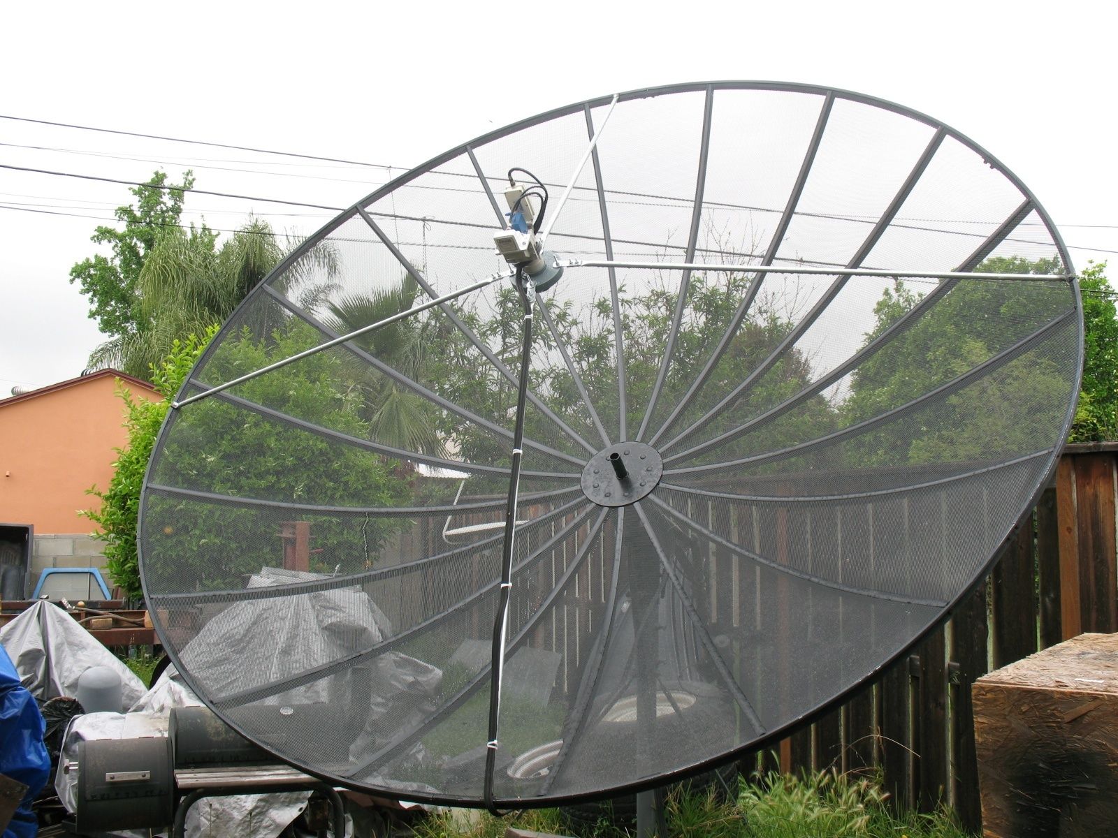

I have a 10ft Orbitron SX-10 converted to quad leg I won't be moving to Oregon.
I'll be keeping the LNBs on the Chaparral feedhorn.You can have the actuator, 11ft pole & about 20ft of flat cable.
Send a PM if interested....we can transport it in the back of my fullsize P/U.

thats a sweet looking 10fter. looks like i've found an 8ft mesh, should know for sure tomorrow.
