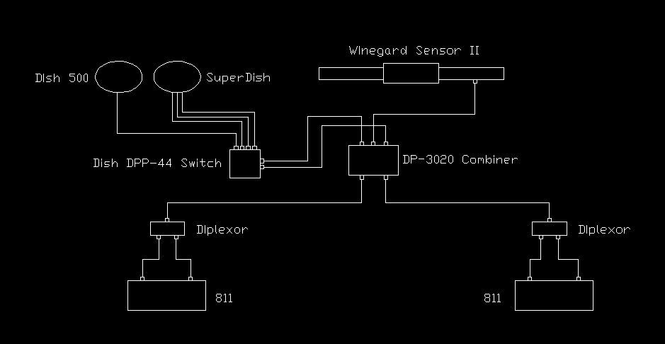

And let's not forget the possibility that the antenna maybe amplified... If it requires 12V, you run a second line, and you're using an 811, you will have to invest in a power injector because the OTA antenna-in on this receiver does not supply the line w/ 12V. For this reason, and the difficulty installing a second run, I got a combiner that also passes 12V to the antenna in from the SAT in connection… What's your exact situation?lrossnm said:I am currently running my ota signal from my antenna through the satellite cable to my 811. Would I be better off running a separate line from the antenna to the 811? Would that improve the picture?
Again, it depends if your OTA antenna needs 12V… If the antenna is not amplified, you just use diplexers (and a splitter if you have more than one HD receiver). If it is amplified, you can get a Winegard DP-3020 combiner directly from Winegard. Connection as per the diagram (complements of joverstr2)…pipman said:How are you getting the OTA connection to the receiver using the one line from Dish Network switch?

I'm confused as to how you could have powered the amp AND have a diplexed line (no matter the receiver). I'm not familiar with the 6000 but I do know that the 811 does not have any power on the OTA antenna-in (which is irrelevant if you were using diplexers which would have blocked the 12V anyway). Any chance you are using power passing diplexers?lrossnm said:I do have a Channel Master amp on the antenna but it does not have it's own power supply. I was using the power from my old 6000 to run it. Does the 811 work in the same way? I had dish hook up the 811.
