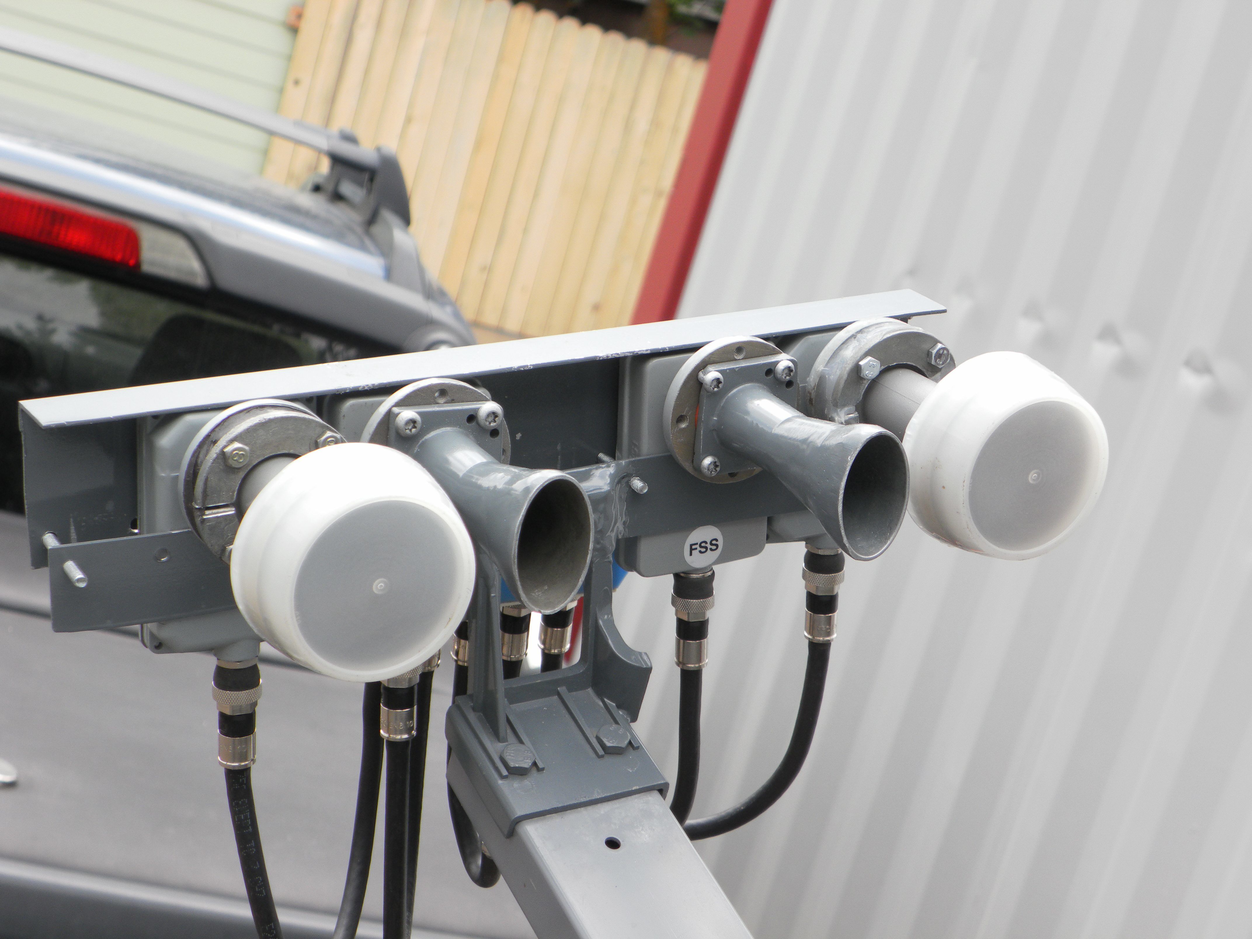

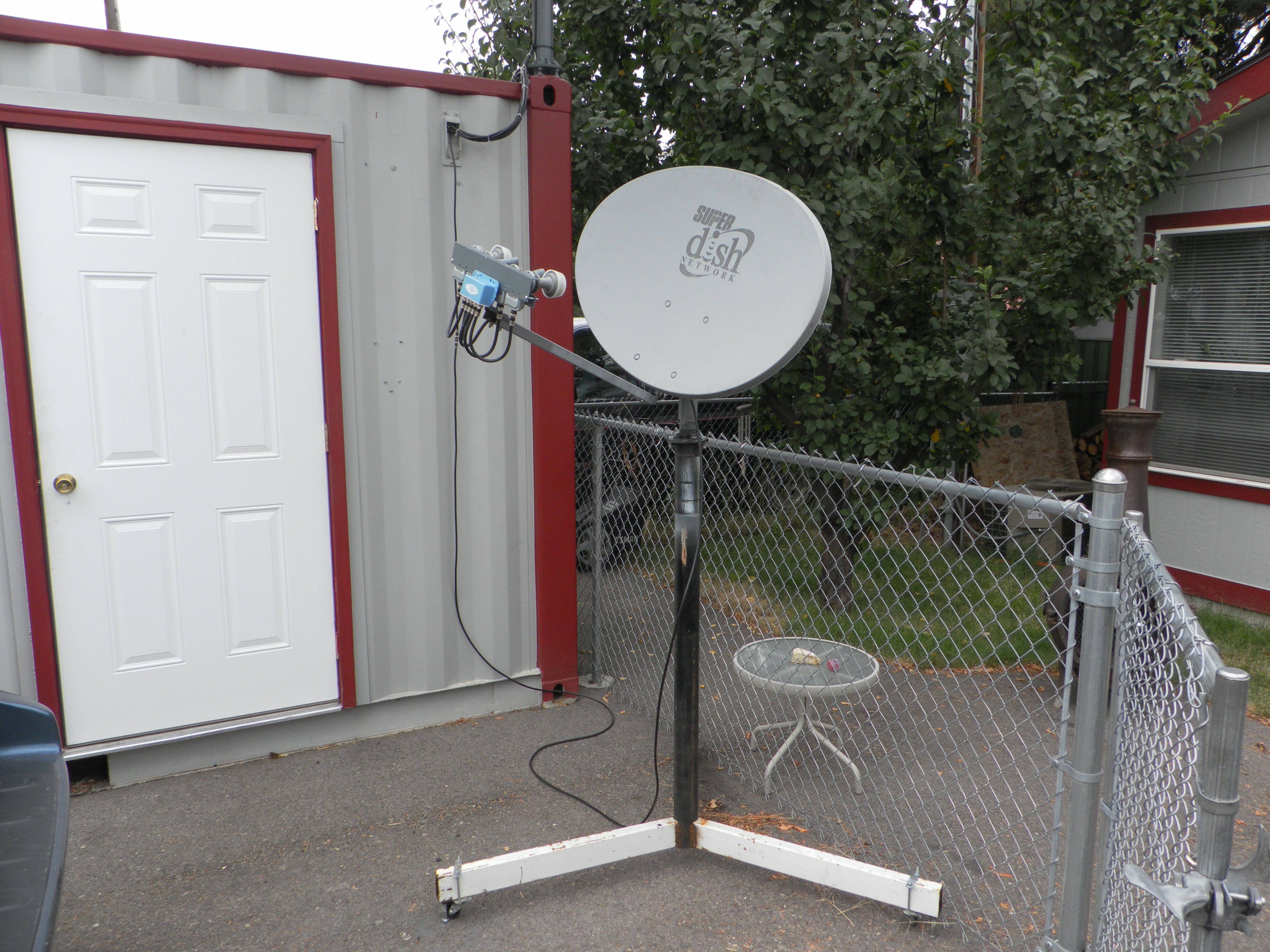

This weekend I had some time to experiment a bit further. I put a small pressure-treated wedge under the 72 LNB to place the skew to the proper angle. That threw off my horizontal spacing but after a little adjusting I was in business. It worked! Some further tweaking is probably in order but all three satellites are once again viewable.

I took advantage of the SuperDish ability to skew the whole dish. Kept the LNBs in line. Here I'm looking at 83w, 87w, 97w, &101w.
