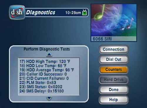

It turns out that this information has been there for the 625 as well. I just got a 625 and checked the temperature on mine by going:
"Menu > 6 > 3 will take you to the Diagnostics screen. Then select Counters. Page Down twice." The temperature on the hard drive will be listed there.
Here is mine:
High 113 F
Low 60 F
Avg. 95 F
What's yours?

User the Page Down in the remote control.
I just notice in the Tech Portal interactive menus that the 522 has it too. :)

So what does all this mean? I suppose that one trained in the art can make some statement about the health and/or long-term prognosis for the system based on those figures. IMHO, it would be more meaningful if a "real time" reading could be had that would allow one to do some experimenting to lower the temp, as mentioned by several posters in the cited thread. What are the "critical" components in the 622 that need thermal management (obviously the HD in one of them) and will the single temp. reading accurately reflect the overall temps. in the box, i.e., if the one indicated is lowered will that reflect a similar reduction for all components? Just curious as I believe a 622 is in my not-too-distant future...
That's a very good point. Is this real time monitoring? Probably not, but it will give you some indication of what your hard drive's temperature actually is. High temperatures will indicate the need to relocate the receiver to a more ventilated area.
