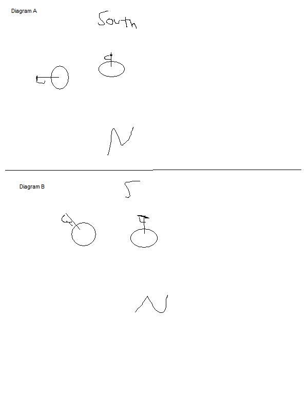

Anyone have any 61.5 pictures? compared to the 110/119. I am trying to figure an estimated pointing area?
Here is a Cheesy daigram which illustration is closest?
Again dont laugh I am no artist, LOL! Thanks!

the easiest way is to break out the ol' compass and look up the azimuth on your dish rcvr for 61.5 in your zip code.
0/360 being due north
I found the easiest way for me to make the change (if you are already pointed at a satellite) was to figure out the difference in elevation and azimuth. For me it was from 148 to 61.5. (I think it was 20 degrees down and 100(?) degrees left). I used the program on dish's website to help calculate these numbers but I believe you can get the same info from your receiver.
The easy part was the elevation as it's marked on the dish and easy to change. I didn't have a compass so I measured the circumference of the mounting pole and calculated how far the the current mark would need to swing based on: (Az change / 360 ) * circumference of pole. I marked the current location and then measured how far to swing the dish and I got it dead on on the first try.
Now I'm Voom'in :cool:
Here ya go :)
far left is 61.5 and righty one is Dish 500 (the middle one is for free to air)
This is from Minnesota
You don't say where you are located. I am near Portland, OR and my 61.5 dish points about in between the 2 you drew that look East.
it wil look close to what mine is...sicne Tulsa is almost south of Minneapolis
the eleavtion will be different
elevation for Mpls 29.4
azimuth for Mpls 138
elevation for Tulsa 34.5
azimuth for Tulsa 130
so it will be a little east of where mine is
