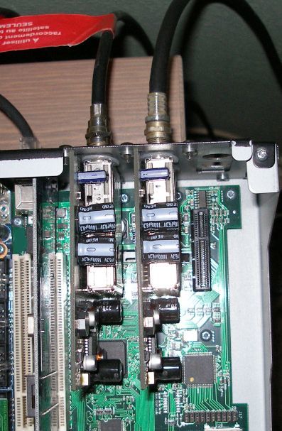

Vis a vis converting the WNC to 18V only lnb inputs, you don't actually need to convert both sets if you don't want to. Mine is setup with 18V on both 0Khz inputs, but the standard 13/18vdc on the 22khz inputs, to facilitate a standard Ku lnbf. I only needed one resistor added ! :)

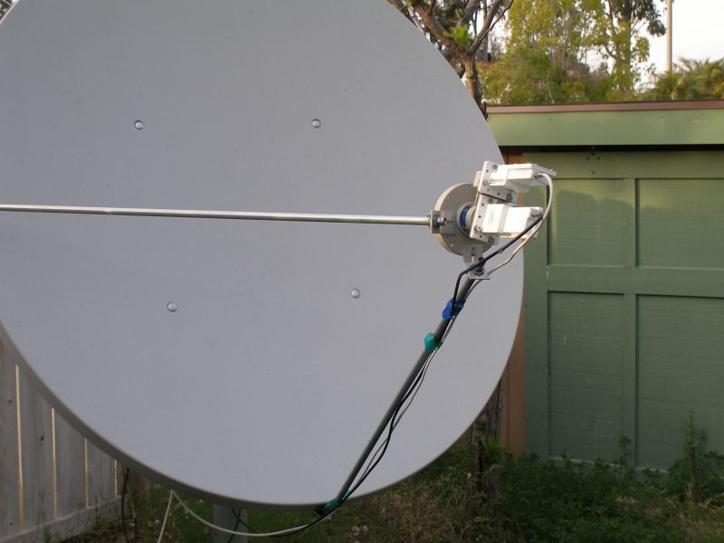

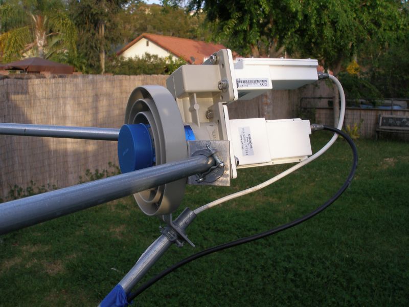

I thought I'd share to the users here how I solved the H and V switching problem on my orthomode feed, 1.8 m C-band setup. I feed cables to each of the Norsats into their own tuner. I tweaked the sources.conf and transponders files to think they were separate sats. I set both to H to get 13V DC. In the tuners setup, just scaned for h transponders or v transponders separately. Some times some sats have nothing on one of the polarities or I cannot get any channels. I had a conical Scalar but something funny happened the other day. I was having trouble getting a particular signal on 107W. Well conical fell off and the station got a lock--one of those DVB-2S transponders that can be hard to get on smaller C-band dishes. Anyway now it off indefinetely. full_dish.jpgh_v_cvr.jpgh_v_lnb.jpg
