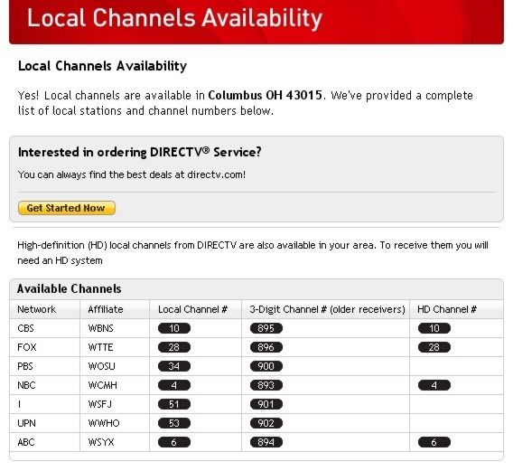

He more than likely got it direct from his install company NOT DirecTV. See attached from the DirecTV database. You might really consider sending him away FAST. Maybe add a nice light complaint to DirecTV and score some additional programming.
