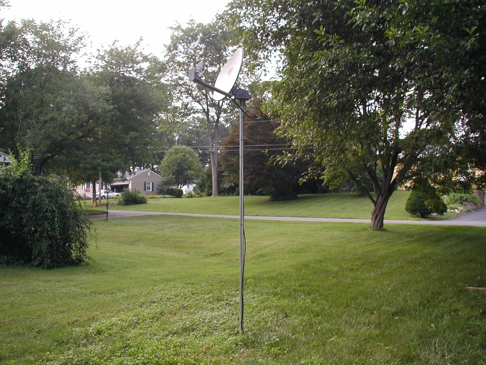

48" would be better. Here is a picture of my install. It's a 12' pole 42" deep.
We're told as techs, to dig down between 30" and 36", no less than that. More won't hurt, if you are going to use a 12 footer I would maybe go down a little more to help stabilize it. As a rule I try to dig down 1/3 the length of the pole.
And the Azimuth/Elevation assembly slips over the top of the pole. ^^
Nice pic there too Raoul ^^
