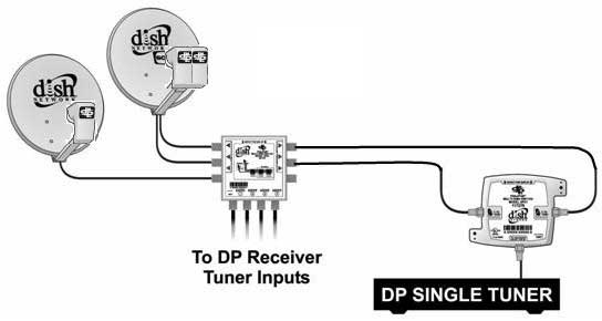

I attached a pic from the Dish Tech portal on the DP34 setup, but I don't see anything about doing it on a DPP44.

well, you can trunk the DP34 off the DPP44 and get 3 of the 4 sats.
To get the 4th sat, could you use a DP splitter on the 129 dish (for example) and then hook 1 feed to the DPP44 and one into a DP21 and compbine it with the feed off of the DP34 for the fifth receiver?

Yes, a DP21 can be used on the DPP44 trunking outputs to feed 119/110 ONLY to a fifth receiver.
As is needing a DP Splitter to get a second tap off of 129. D1000's come with DP Dual LNBFs, so it's already "split".
Finally, yes, you CAN trunk a DP34 off of a DPP44, and then cascade a DP21 off of the DP34 to add the fourth bird. If you need yet another feed of the fourth bird, a DP Splitter and second DP21 will git-r-done.
Just remember that the receivers connected to the DP34/DP21 MUST have a separate feed cable for each tuner (DPP Separator will NOT work).
