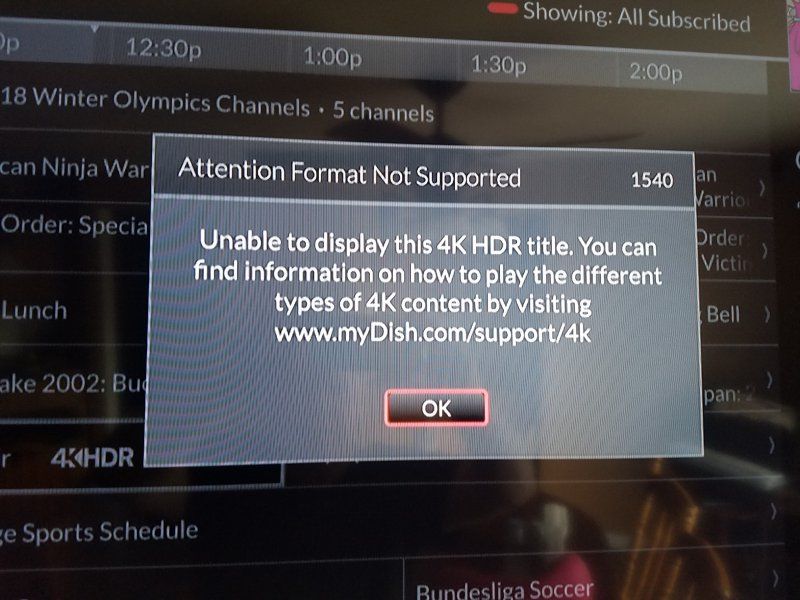

I'm getting the "Attention Format Not Supported" 1540 error as well. I see a program scheduled for 1pm CST for Olympic coverage for 2.5 hours, and it will not even allow me to set a timer for it

Today I called Tech Support, they're filing a ticket as they admitted the issue sounds like it's on their end, since my TV fully supports HRD (OLED65C7P)
and we are seeing multiple reports that non HDR TVs are not getting 4K, just incompatible TV messages.
That is what I am getting at my H3 that is connected to a non-4K TV.

OK I have discovered my issue...if I pass the Hopper straight to the LG, then it works. If I pass it through my Denon X4300, I get the error screen. All connections using Premium Certified HDMI cables from Monoprice. So for some reason the Denon is the issue. The Denon is fully 4k callable so it SHOULD be able to pass whatever it's given my the Hopper.
X4300 needs a firmware update to support HDR.

Yes, I have an X2300 that has the update and it passes HDR just fine.
So you're successfully passing your Hopper 3 through your Denon 2300 and getting HDR? No matter what I do, the only way I'm getting HDR from Hopper 3 is running it directly to the LG. I have no issues with any other HDR (or even DV) signal passing through the Denon. Weird.
Yes, I am seeing HDR10 at my Vizio going through the Denon.

According to AVS forum you should be able to watch 4K HDR content on a non HDR TV. The HDR signal is just ignored but you still can receive the high resolution. It would be similar to watching a program with Dolby surround sound on a TV that only supports stereo.
I would check with Dish an your TV manufacturer to find out why your TV is showing up as not compatible. Are you using the correct HDMI input? Some TV's only have one HDMI input that produces 4K. Hopefully, you will find a solution that works for you.
http://www.avsforum.com/forum/465-h...g/2542505-hdr-non-hdr-tv.html#/topics/2542505
I called my TV manufacturer who is telling me that HDR is a hardware feature and my set does not have that hardware and will not be able to receive the HDR signal. I was hoping it was firmware and I could get an update.
Perhaps the Denon was released before HDCP 2.2 became a real thing. I have a newish Onkyo receiver that has three 2.2 hdmi inputs and three that are standard hdmi.
