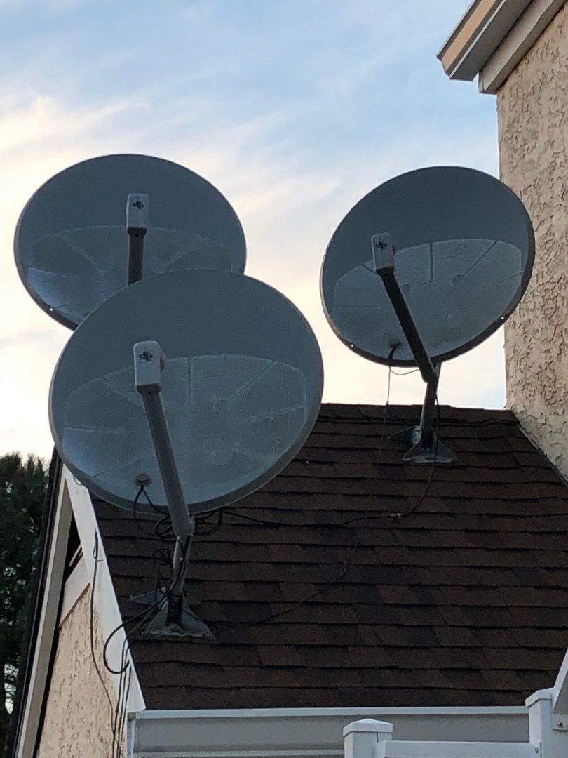

If you found it next to a dumpster, then my guess would be it was used as part of a hotel or bar setup for Dish Network. They sometimes use those 76cm Winegard dishes for corporate installs.
BTW- they are very high quality dishes. I have two of them.

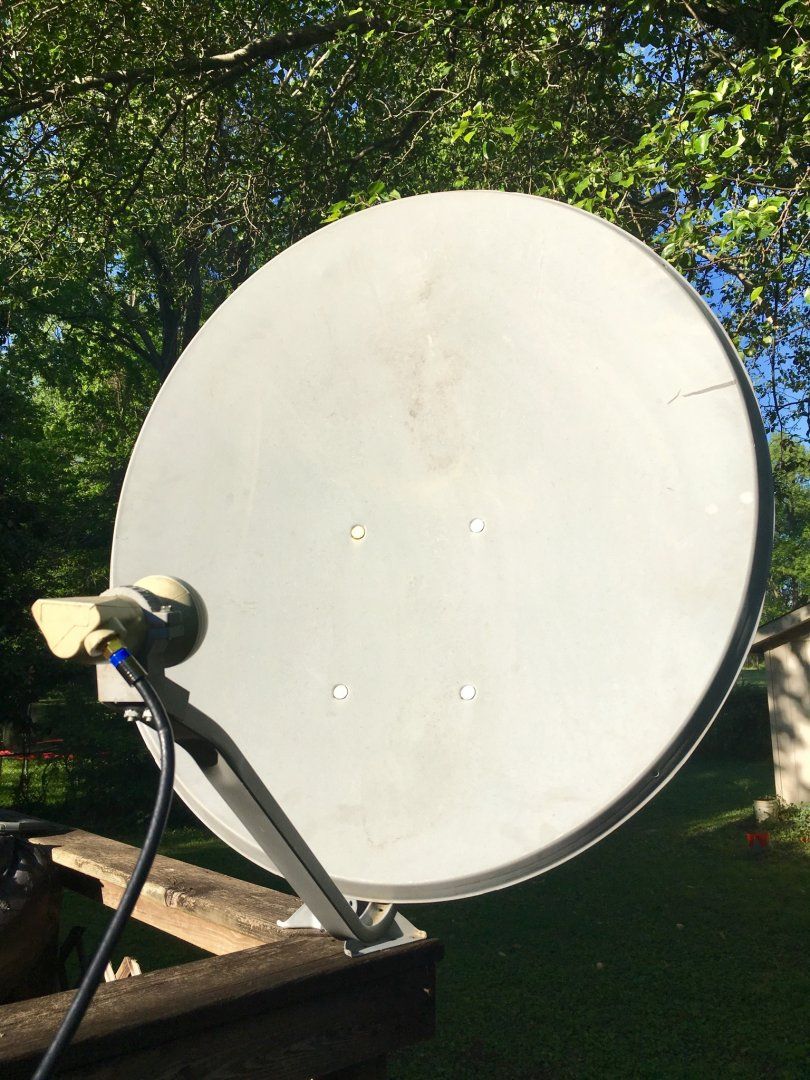

I can't get a signal no matter what I do. The pole is level and the skew, azimuth and elevation are correct. I guess the LNB is bad. I'll have to order another one.
Here's a photo. I guess the LNB is bad, because everything is lined up. I tried going up and down, left and right, and turning the LNB. No signal. I'll have a new one in a couple of days.
That's definitely a Winegard DS-2076. I have two of them. It looks like the feed arm could be bent. That might be your problem.
I agree, I think it's bent. MANY people remove them from the foot, and throw them off the roof...
It's not easy to fix a bent arm on an offset dish, UNLESS you have a duplicate dish and can match everything up to it. It's far better to get another dish, if you can find one.
Reactions: comfortably_numb

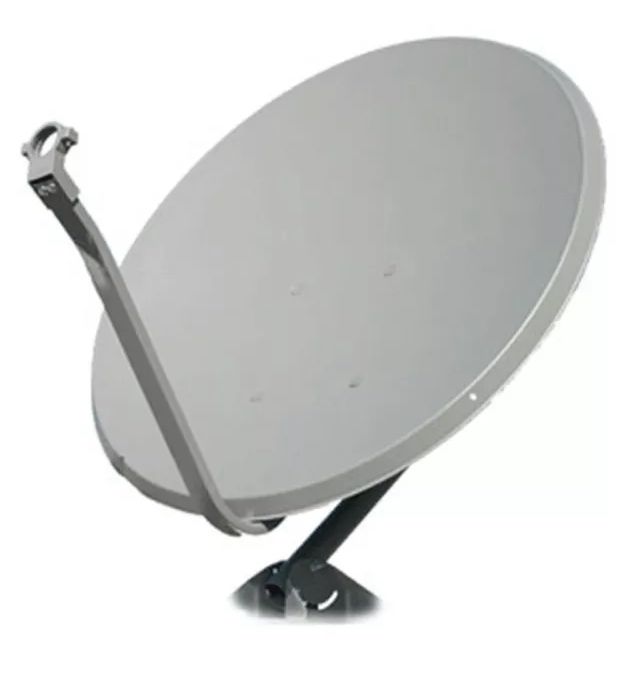

Luckily, that one is cheap and plentiful from Solid Signal via the link I posted before :)
