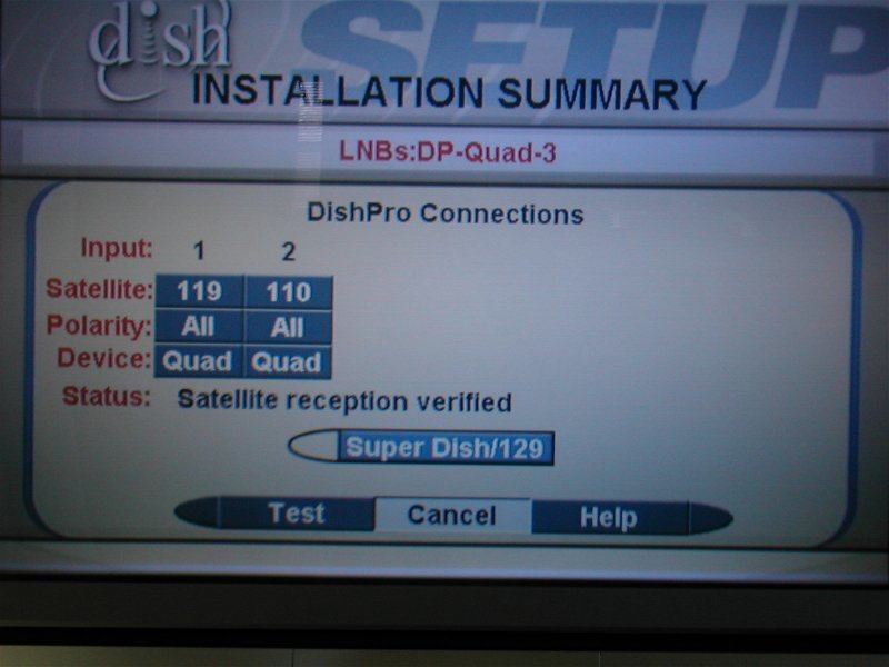

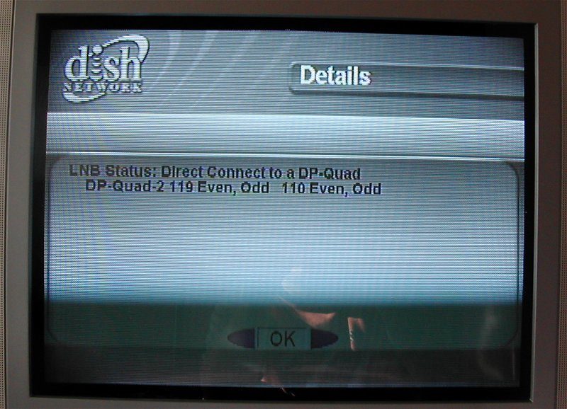

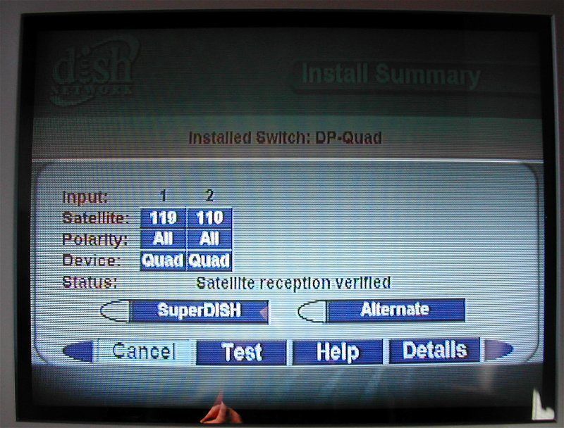

Go to Menu 6-1-1 and check switch go to details and it should give you your electronics setup. Hopefully you would have a DP Twin with a DP-34 switch that would allow 4 receivers off the existing electronics. Adding a second DP-34 switch would allow upto 8 receivers. I believe DISH'S suggested retail on a DP-34 is $129 but from about $20 you can find "working" DP-34s just shop Ebay. 5 receivers is uncommon because DISH has decided to do their LNBs and switches in multiples of 4, a Quad will support 4 receivers but to add the next 4 runs about $100 for the additional plus the cost of the receiver. :)
Thank you, that is basically what I have been wondering. If memory serves me right, I do have the DP Twin and DP-34 but will check tonight. So if I have that, I can simply run more RG6 cable out to the dish, hook up the cable to the extra spot in the DP-34 switch and plug in my newly reactivated receiver and start enjoying? That might be the way to go, and then back feed one of the 811 into a bedroom or something.

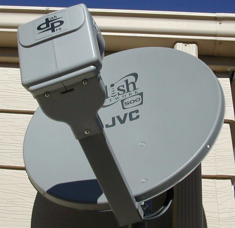

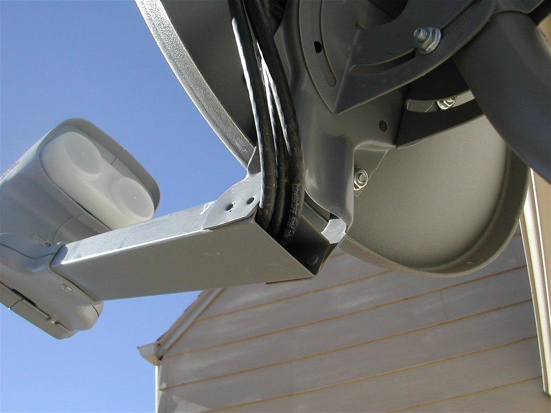

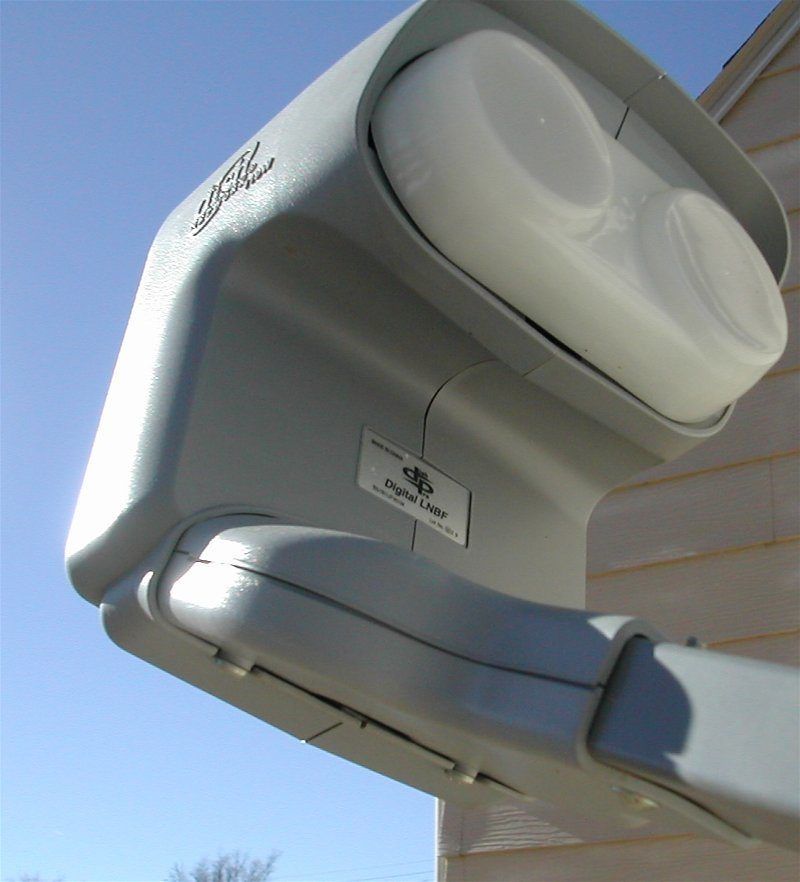

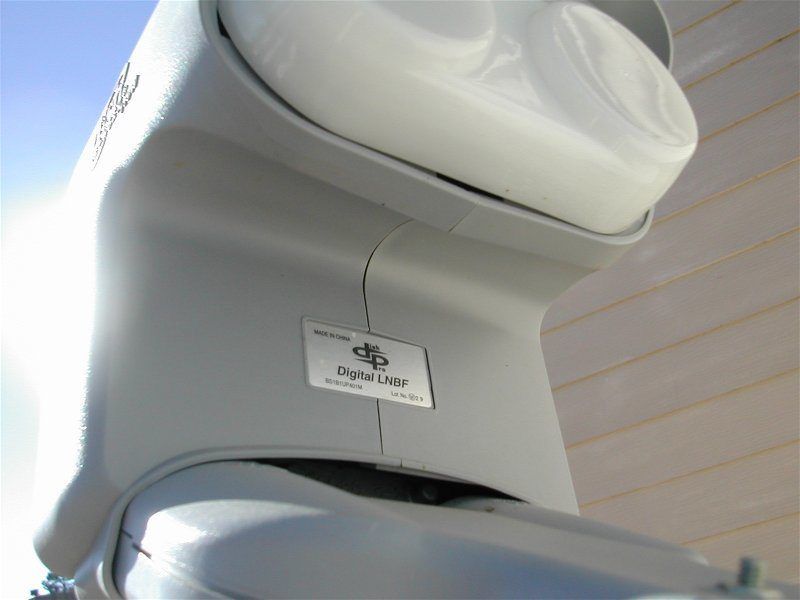

Ok, went home at noon today and checked it out so there is no confusion.
Attached is what I have, how do I get at least 4 rooms or better yet, 5 rooms. What parts do I need, is this a DIY install or should I hire it done?
The other thing I was thinking is the fact that I subscribe to my locals but don't have the 2nd dish to get all of them, by choice. What if I called E* and requested the second dish, would that help me out at all to get more equipment or switches etc to help with what I want?
I only have about 2-3 weeks to decide what I need/want and get it done. So all the help you can provide would be much appreciated.

peid & jrapps: You need at least a DP34 added to the mix.
For those tuners that only need 2 birds, they can run off the leftover Quad feeds.
If (and only if) more than four tuners REQUIRE 3 birds, then a second DP34 is needed.
Side note: For additional 2-bird capacity for one tuner, a low-cost DP21 can be attached to the DP34 cascade ports.
Simple Simon has it, that is it. You have a dpQuad now to go to more rx's with getting locals on all Rx's you need a dp34 switch, that will give you 4 you want 5 I think....you need another dp34 cascaded to get up to 8 so there you go. But like simple Simon said if you don't need locals on all Rx's then the Quad and and one Dp34 will do
So if I get this DP-34 switch, all I do is replace the one which is inside the dish now, near the LNBs and boom, just like that 4 rooms? I don't quite understand looking at X # birds. I think I am only looking at 110 & 119. Are those birds? To look at another bird, say 61.5, I would need the 2nd dish on the house correct?
What would I gain, if anything, if I requested the 2nd dish be installed for free to receive my other locals, but then re-aim it at the same 2 birds I am already looking at? Wouldn't I have another 3 rooms off that 1 satellite? So that would basically take me up to 6 rooms wouldn't it? 3 Rooms off existing dish, 3 more rooms off 2nd dish? Or am I missing something?
The Quad's swiitch is built-in - you can't touch it, nor do you need to.
birds are satellites. Some of us use that term because too many turkeys call the dish antenna and/or receiver a "satellite". :no
Yes, a 2nd dish would be required for 61.5. It's typically NOT the same type.
However, if you don't object to a second dish, just get another 500 with a DP Twin on it. That gives you 2 more feeds for a total of 6. Costs around the same as a DP34 - but with 2 separate dishes, you won't lose all your TV to a single hardware failure - EVER. ;)
