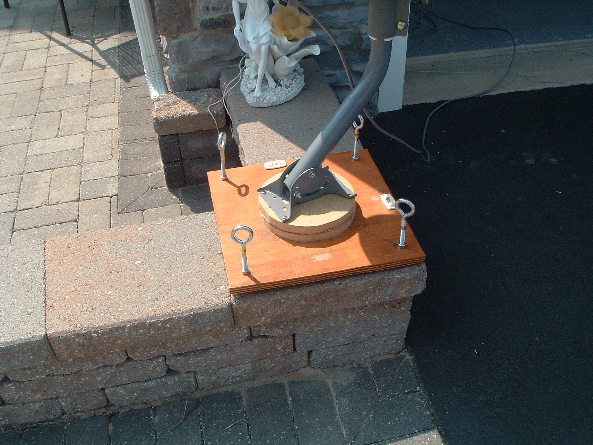

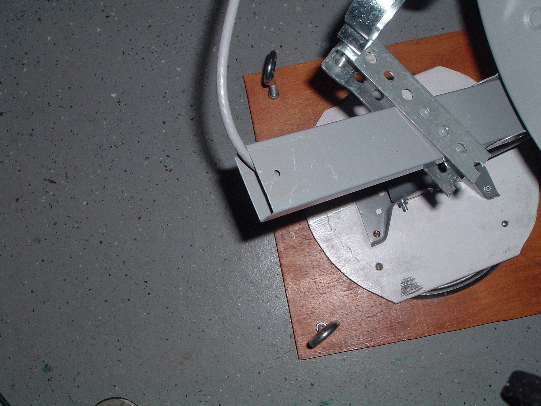

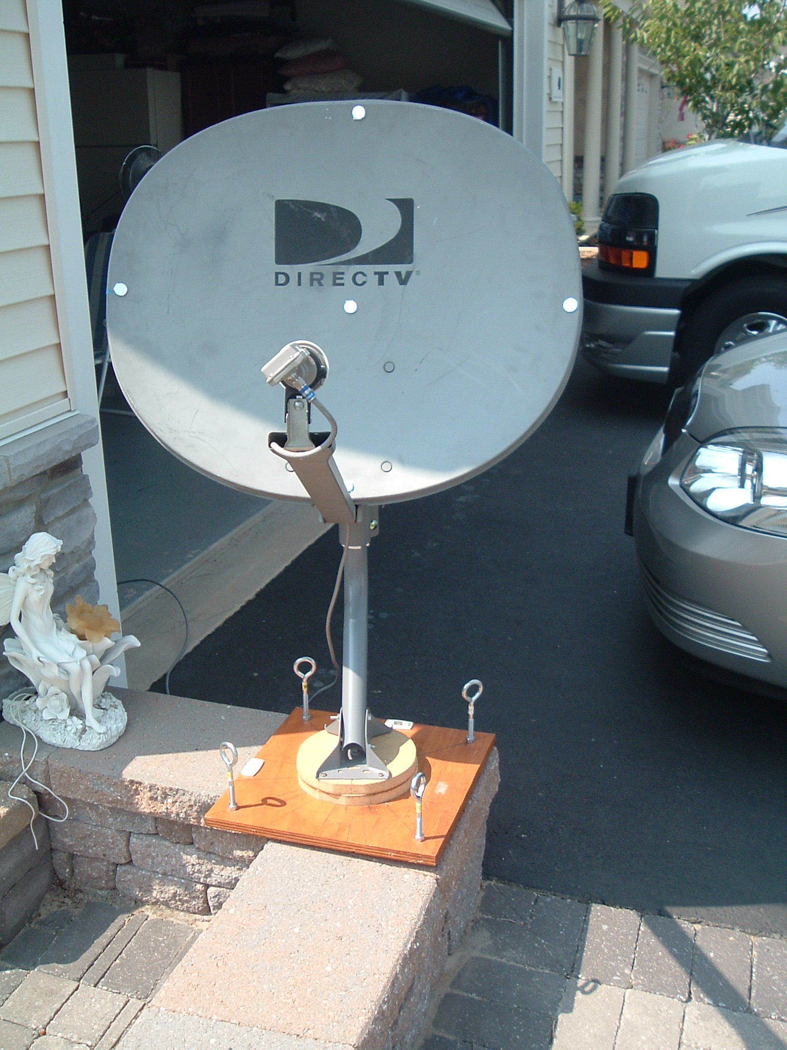

Well I started about 3 years ago with a lazy susan under a 500 dish, check out pic (dish3).
I have improved the design by making my own lazy susan (pic dish1 & dish2) by using a section of formica counter top.
I use the dish and the lazy susan mounting all the time. I can go from 61w to 97w with only minor elevation and skew adjustments.
I use it alot when I work in the garage and try to catch CNBC on 72w.
And to watch the Naked City on RTV at 83w.
View attachment 77786View attachment 77787View attachment 77788

BTW the weight of the dish on my home made lazy susan is enough to make turning the azmuith for satellite alignment easy and comfortable. I adjust the azmuith all the time to pickup different satellites. On windy days I but a bucket of sand on the wooden platform to stop it from being blown over. So far the wind has never blown the dish out of a satellite alignment.
Before you purchase the lazy susan you can experment with two pieces of wood and some stiff plastic sandwiched between then to try out your idea. also you can go to Home depot or Lowes and see if they have a remnant piece of a formica counter top thats cheap and use that as a lazy susan.
