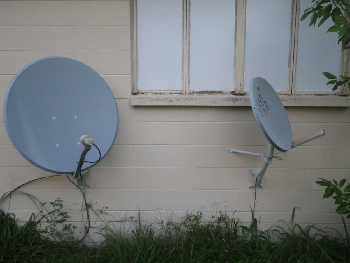

Thought a picture of a 76 CM dish next to a Dish Network might help with your decision on what to start with. Just happen to have a 76 CM (think it's a Winegard) next to an unused Dish 500 (21x22.5 inches) Something I find interesting is the 76CM is in use and locked on 117W for Orby TV. I think the Dish 500 was on 110/119 but check out the elevation and azimuth - the Dish 500 looks like it is pointing much higher and much more south.
Anyhow I have had very good success with the smaller FTA dishes. If you really want to try and keep things on the smaller side the 76CM may be a good choice. Can be bought for $60 or so. My take on the size if you are going to use it fixed for SD and feed scans the 76CM can work great. If you think you might want to install a motor then go bigger. The one thing I'm not sure on if you will be able to use the 76CM for HD. Might have to have more margin for HD S2.
Hope this helps, DC
Hope this helps, DC
