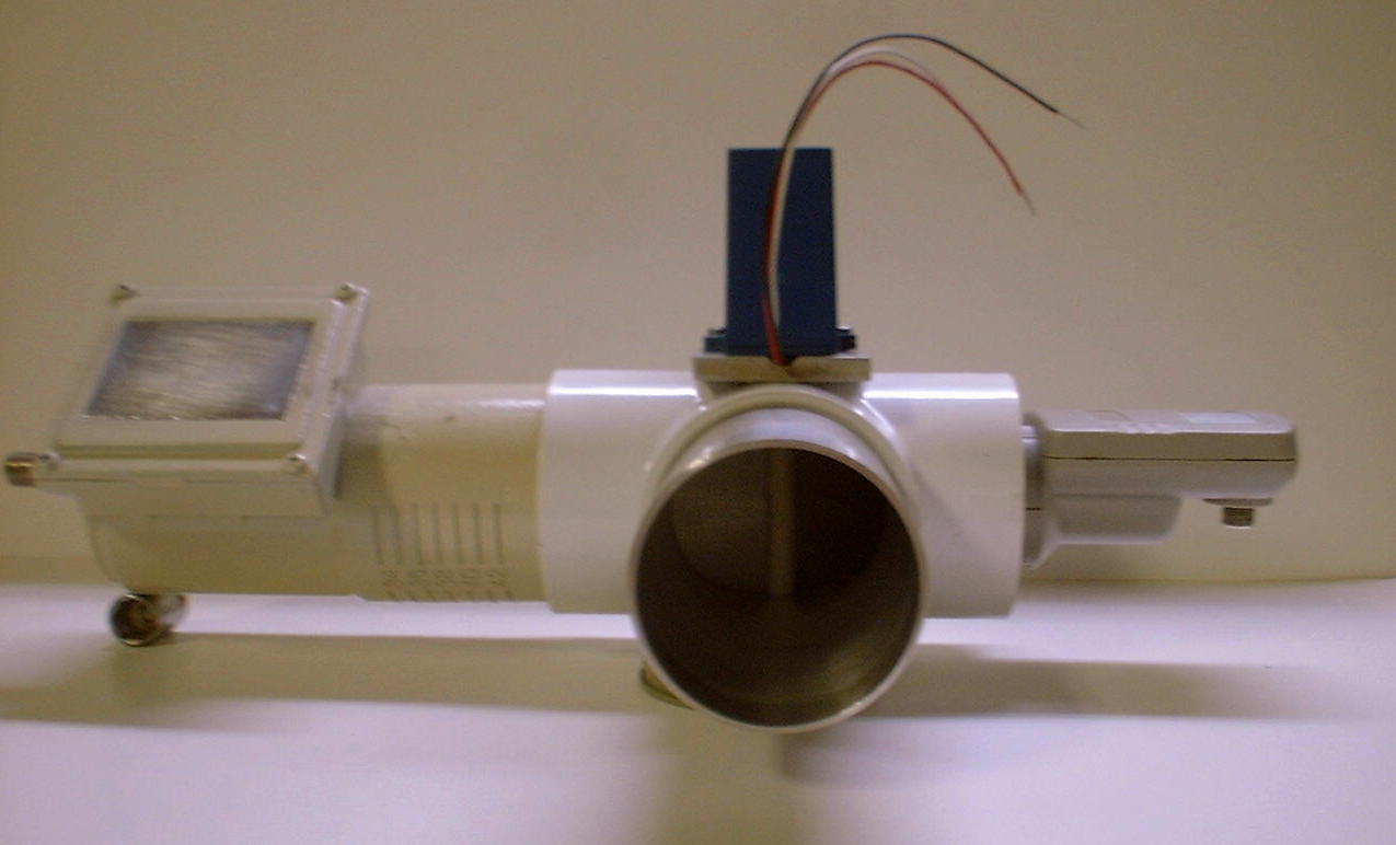

C band, dual feed
Some time back I wanted to try a C/Ku feed experiment. I was only able to recieve maybe 75% of a stand alone Ku lnb with this unit. But, it worked very well for the C band !! I've been wondering about adding an analog lnb to the unit, but as yet have not tried it. The plastic "T" is lined with aluminum tape from the hardware store. The oval shaped reflector inside is mounted on plastic pen cartridge. The motor is operated by my Pansat 2700a. Takes a bit of time to build, but can be done. I have a number of other things to do and have to try and distance myself from spending much more time with the satellite experiments. Best wishes !!
