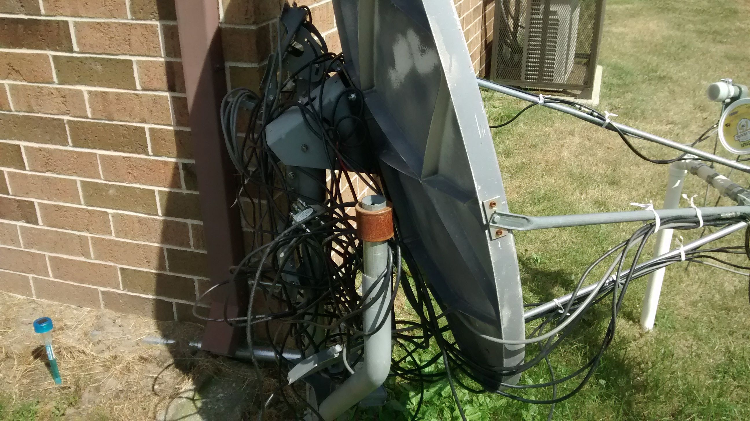

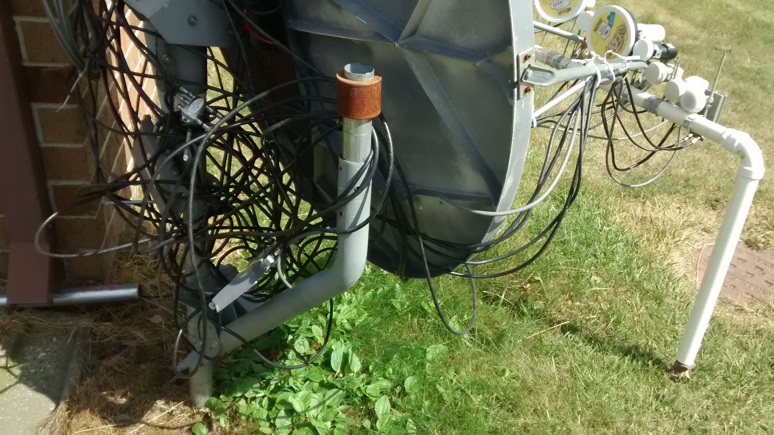

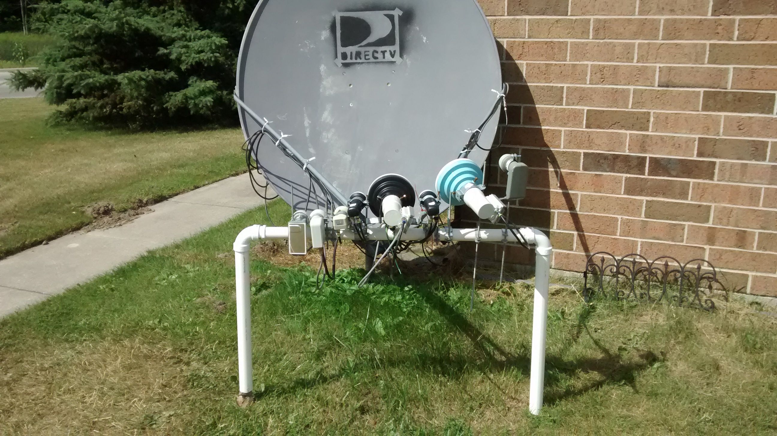

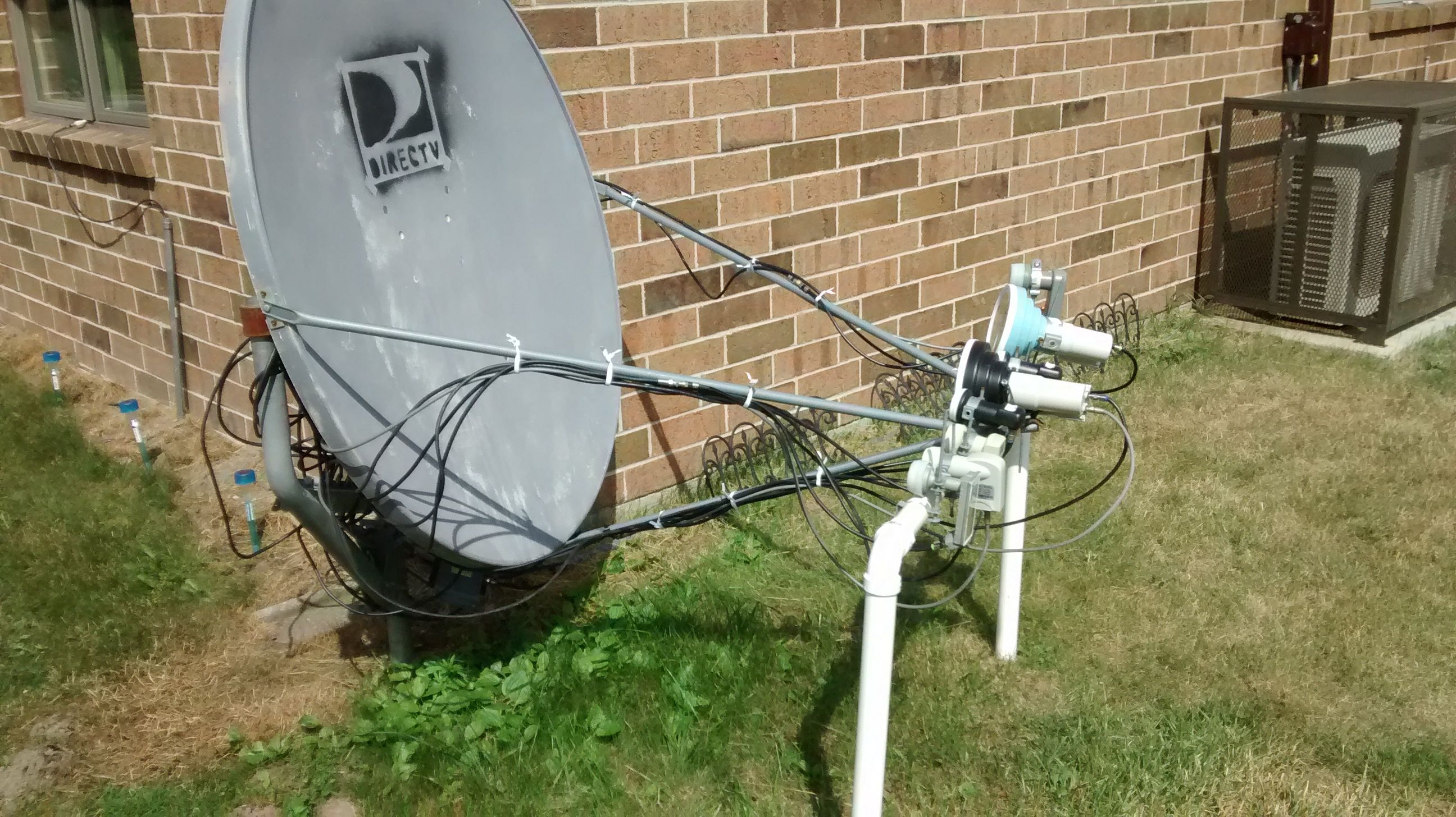

Don't be down on yourself look at my setup its got so many adapters its crazy wires looks like a hornets nest. Use your meter on your receiver I use a map compass those are lot better than using your phone. Take your time get it done right.
Oh my gosh Danrishtheman, that is just one awesome setup! If you have more info on what each lnbf is hitting, send me a link. Would love to know what your db levels are on the various birds. WOW!
Thank you. Starting from right to left 110w to see if anything is open, 107w c band around 70 on q on able 2 get transponders. 103w ku from 72q to 84q, 99w c band lesea channels 65q., 93w,95w,97w ku, depending which way to aim the satellite dish. 91w ku 74q on ABC transponder, 87w ku 65 to 70q on CNN transponder, 82w to see if anything is open. I don't have a signal meter can't give you a db rating. It all how I move my dish around. Does the quality go down if you add more switches I have a directv swm power inserter how can I use this with my setup?
