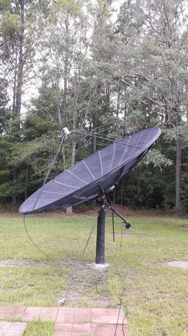

12ftr. Aquired!!

still working with it....have the elevation set, checked the LNB to insure the probes were lined up correctly, hooked up the meter and shows 79-80% Q but nothing else....and it beeps on occasion, not sure what that is, next is too get the dish lined up true south and rotate it on the pole like you had recommended and see where that gets me.
Would a 12 footer look good out here?
Ajak HH mount
