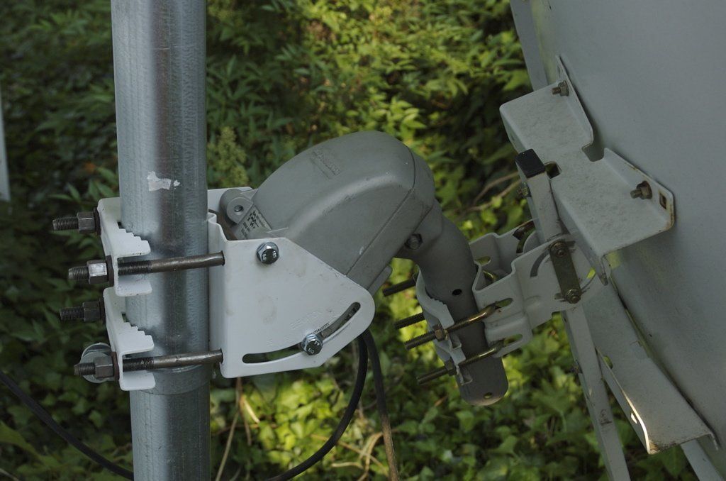

Interesting reading about your Fortec 90cm dish.. Your mounting bracket assembly doesn't look like mine, and I wonder if your instructions were for my style of mounting bracket (see attached photo). When did you get yours? I really have no idea when I got mine now but I think it was sometime around 2002.. I am fairly certain that my dishes elevation markings are not correct from aiming it numerous times. Usually when aiming the Fortec I just eyeball the elevation and tweak from there because I never trusted the markings on the dish. The elevation angles on the motor (although I have a DMS not Moteck SG2100) are correct.
Also have you had any problems with your motor u-bolts and bolts rusting? I ended up replacing all of mine when I remounted the dish the other day.

I wasn't sure when I got mine either, but I looked it up, and it was back in 2006, which was about when my BUD started to give me problems on Ku due to dents from hitting it with a broom in the winter to knock snow off. THe mount you have is the so called U-bolt mount that Sadoun sold. I got what they called the pole mount. Everyone I've talked to who got the U-bolt mount has said that the elevations were off by about 5 degrees, so I really have assumed that it was a generic mount, not specifically made for the 90CM. I haven't noticed any rusting, but mine isn't very old yet.
But back to the lnbf arm, I also found that if you're not careful about how you tighten the bolts that connect the brackets to the dish that the lnbf arm can aim left or right of center, ie not be square to the dish. And re the arm bending, there was one guy on the Sadoun forum whose 90 CM had it's lnbf about 6 or 8" out of position, almost to the extent that it looked like a prime focus. I really trust dishes that have 2 side braces in addition to the main arm, because there is no way that the lnbf can get much out of it's proper position with 3 arms. The good thing about the Fortec dish is that it's light, and isn't much of a load on the motor.
Cletus2k, the motor U-bolts made for the SG-2100 at that time were very problematic. They were subject to breakage and stripping... It was very easy to strip them without even tightening them much. They have since been replaced by far better hardware.
