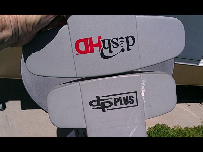

I just found out about that a few days ago myself. I have a turboHD dish and no LNBF. I asked my buddy who works for dish if he had an extra and we looked in his truck. All he had were the ones for the 1000.2 dish and he said they would not work because it's a different size dish and spacing. A day later he brought me the LNBF I wanted and it looks just like the one you have pictured. I 'll try and get a picture of both of them together so we can see the difference. It's confusing because most people interchange the two dishes, but one of them had an early version and is not used any longer.
Your Lnb looks just like mine

Judging from the relatively even spacing between the feed horns, you appear to have the appropriate LNB (although there's a possibility that it is a 1000.4 WA LNB assembly).

The top one is 1000.4 and the bottom one is 1000.2

I think the problem you have here is the wrong LNBF. The one you have is for a TurboHD dish. It's smaller than an 1000.2 so the LNB spacing is wrong.
TurboHD is a 1000.2. You must be thinking of the original 1000. It utilized the DPP Twin and a DP Dual. It was much smaller.
I think my buddy who has been installing dishes all his life and is now in his seventies, is suffering from CRS. The TurboHD is a 1000.2, and the dish they use here now is the 1000.4 and that's what LNBFs he had on his truck. He had is model numbers messed up. LOL
