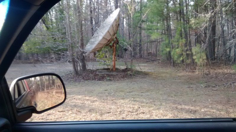

Been a while guys. Here is an update. This is the other dish. Decided to get it while the lady's yard is dry.
Reactions: FTA4PA
I never could get the dang button hook to loosen up so I could remove it for transport. Had a buddy with a wide trailer lined up to help me get it home tomorrow. I decided to take a pipe cutter and cut the back side down (of the button hook ) so the thing would lie flat in the trailer. I tilted one side up so I could brace it off to get underneath it. CRACK! the whole thing broke right down the middle, fell in 2 pieces, then one side of that broke nearly in 2. I took that apart then took the other half apart.
But, I ain't licked yet. As many sorry boats as I have resurrected this should be no big deal.
And yes, including the F-up, I did it all by myself.
If there's no name, it's knockoff of channel master dish How are you going to put it together again, I see all the plastic broke, if it's a good one it's fiberglass the cheap ones where plastic with a thin layer of mesh embedded, in the reflector
Just look at the parts that are broke no fiber material its knockoff that's a vonwise there also
Plus I think the real ones used SS bolts that would not rust up, which I assume it's broken apart
